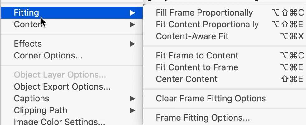

OR resize the frame itself as you were doing, then with it still selected, choose a Frame Fitting option from the Object > Fitting menu to automatically scale the image itself to fit the frame.

Once you resized the frame/container to fill up the entire page, it covers up the items below it (like a sheet of clear plastic), so you can't select through it by straight clicking. Resize the image frames by using the Object > Fitting > Fit Frame to Content menu or the button on the Control panel.

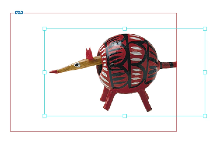

One slight correction. He says the image frame is usually brown that's often true. But to be a little more precise: The selection colors you see for objects depend on color selected for the Layer you're working on (shown in the Layers panel—found in Window > Layers). The default layer is a light blue color and that's what most objects show on their bounding box, including graphic frames. The color of the image frame inside it is the inverse of blue, which is brown.
However, when you work with documents with multiple layers, the layer selection color may be different. The graphic frame could be red. In that case, the frame of the image inside it will be light blue (like the example shown below).

It is important to understand that when an image is imported into InDesign it actually is two separate components—the container frame (offically known as a Graphics Frame) and the image itself. Think of the frame like a soup can and the image like the soup. To manipulate the image inside the frame click on the inside of the frame with the Direct Selection Tool (the white arrow). You will notice a hollow translucent circle appear in the center of the image. Dragging that circle with the direct selection tool will allow you to move the image within the frame. Additionally, when you click on the image you will see a (usually brown) frame appear with corner handles. These handles will probably appear ourside of the container frame and will define the actual outer edges of the imported image. Dragging the corner handles of this (brown) box will allow you to enlarge and reduce the image. Drag with the shift key held down and your sizing will be proportional. If you wish to alter the the outer container (the graphic frame) click on the outer edge of the frame with the regular selection tool (black arrow). If the frame is on the default first layer then the outline of it will be blue. Each layer you add to the document will show the frame in a different color which makes it easier to see which layer a frame is on. If you drag the corners of the selected container frame you will enlarge or reduce the perimeter of the frame. If you hold down the Command (Mac)/Control (PC) key when you drag on a corner then you will enlarge or reduce the frame and its entire contents. Hold down the shift and all enlargement and reduction will stay proportional.
