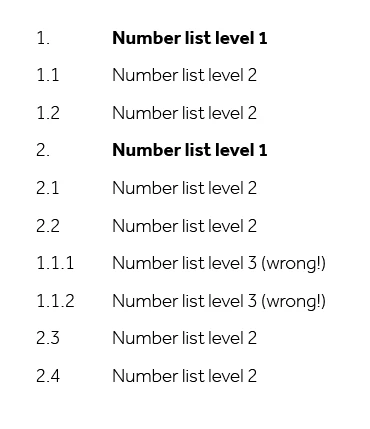

However, this is happening:
Whatever I try, level 3 restarts at 1, so for example I get 1.1.1 instead of 2.2.1.

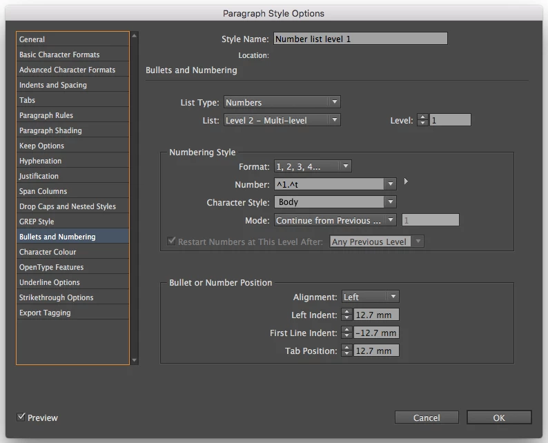

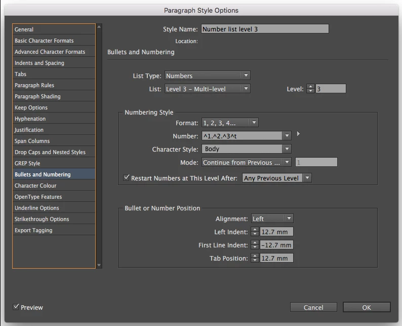

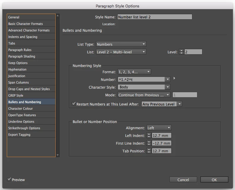

I'm using three numbered list paragraph styles as follows:
Level 1:
Level 2:
Level 3:

Correct answer Mike Witherell
Your third screenshot shows that your Level 3 points to a *different* list. Make it the same list as the other two (in your case, choose Level 2 - Multi-level.)
When you make a different custom named LIST, you are instructing InDesign to number differently and independently of your current list pattern.

Mike WitherellCommunity ExpertCorrect answer
December 15, 2016
