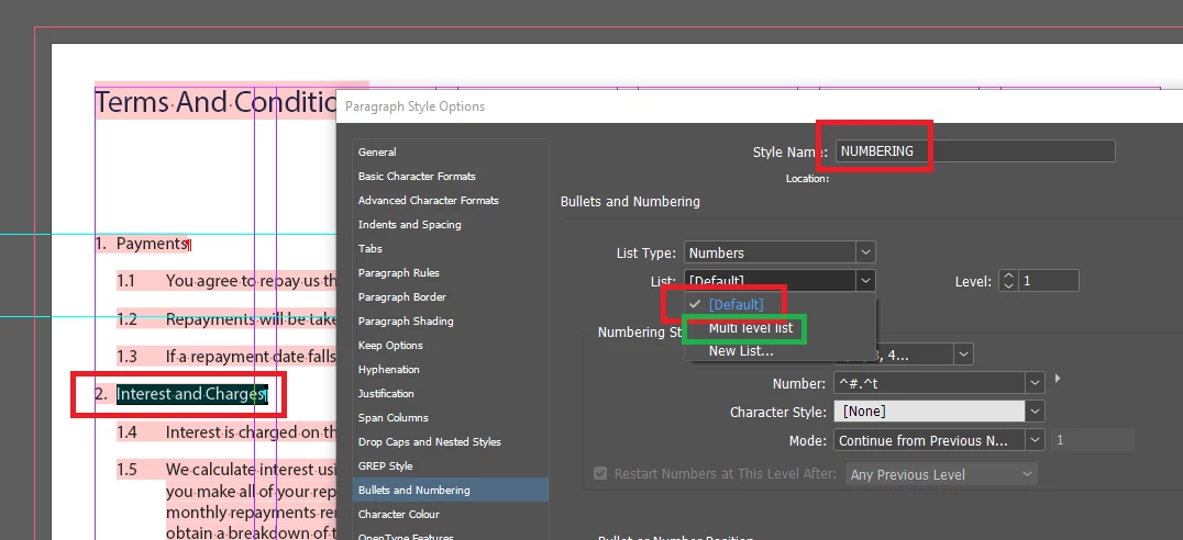

Can someone help me with the second level numbering on this doc please - page 5 onwards? After 2. Interest and Charges, the next level should be 2.1 not 1.4. I have clearly something set up wrong in the paragraph styles but I am not sure what.
Any advice very gratefully appreciated!

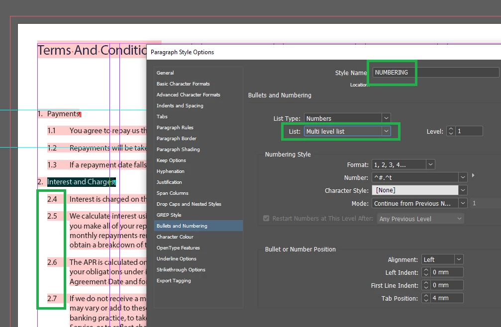

    Robert at ID-Tasker
    Apr 15, 2025 6:00 PM UTC
    @Gabr1elleCD
    Your NUMBERING ParaStyle - 1st level - uses wrong "list":
