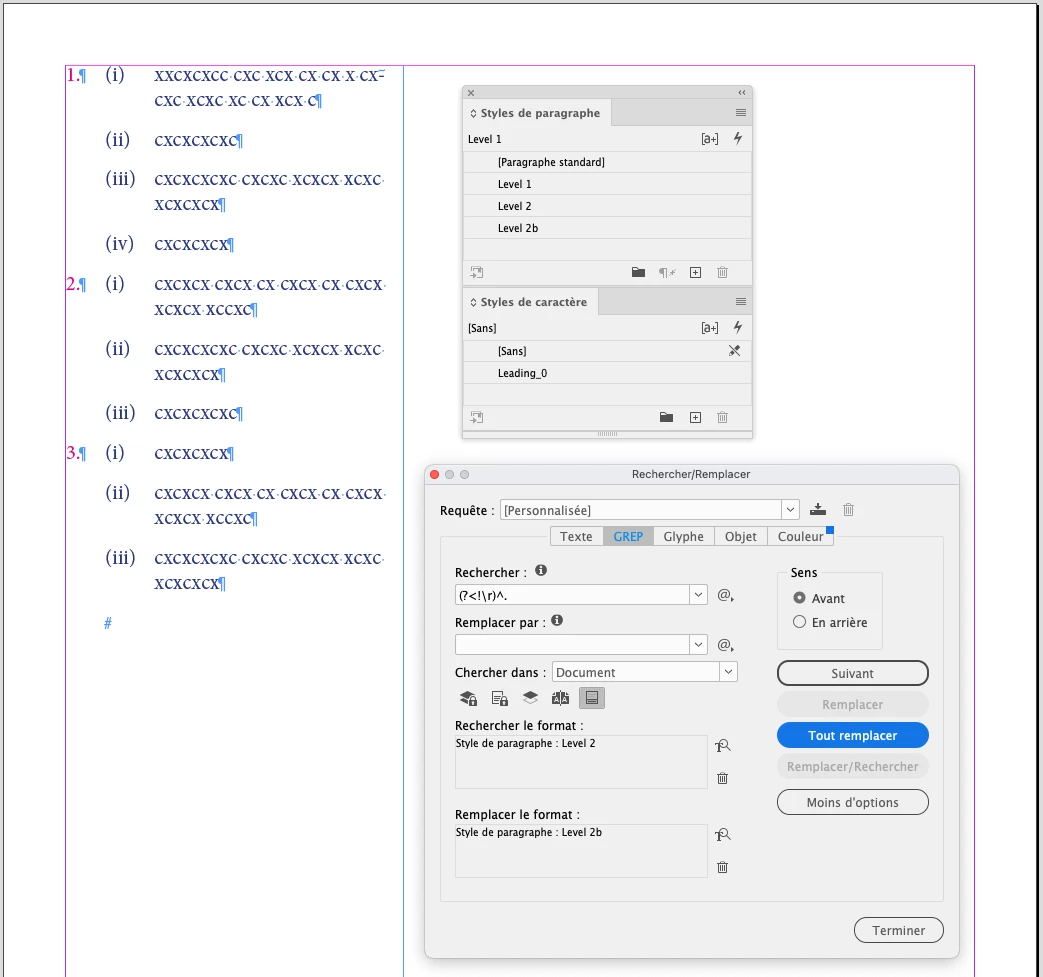

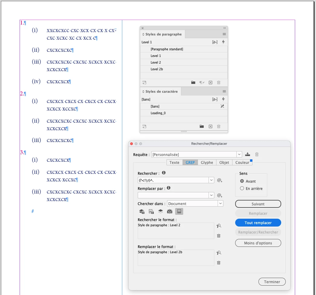

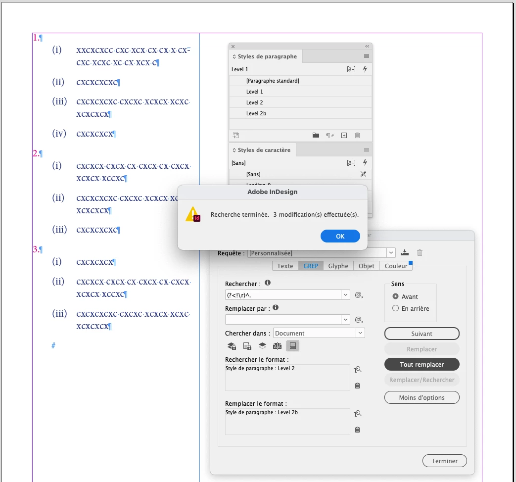

Simplistically, with just a Find/Replace 1 click to play all the document!

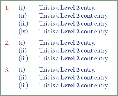

The short answer is that no, you probably can't do what you're seeking, as InDesign manages lists/numbering on a paragraph by paragraph basis and it has almost no facility for putting paragraphs on the same line. There is one potential workaround — more a hack, really — but if it works it will only do so at the cost of other complications.
One approach —
  • Set up your Level 1 and Level 2 numbering so that they stack and number as you wish.
  • Set both to have the same line spacing (say, 14pt).
  • The Level 1 head can have Space Above, but no other space above/below can be used in the list.
  • Set your level two (roman numeral) style to baseline-shift up the leading amount (+14pt).
This will produce the effect you want, but at the cost of having weird "phantom" lines in the document at the bottom of each Level 2 stack, and editing will be a little odd as the cursor will be a line below the text, etc.
You can also —
  • Create a child style for the second level, Level 2 cont.
  • Set the Level 2 paragraph style to have zero leading, which will only work for the first item to follow a Level 1 head.
  • Set Level 2 cont to have 14pt spacing, and use it for all subsequent second level items.
Again, you'll have editing adn cursor oddities with that scheme, and it will take considerable careful management. Among other glitches, the first Level 2 entries cannot be more than one line lone. But if there's a third method, or anything more integral to ID's features, I can't think of it. (ETA: WA's technique with tables may be the only "canonical" way to get multiple paragraphs on the same line, but then every list will have to be in a table structure, which may be too limiting.)
The latter approach does allow a bit more flexibility in spacing etc.:
(Ask away if any of that is not clear. It's a kind of tangled setup.)
