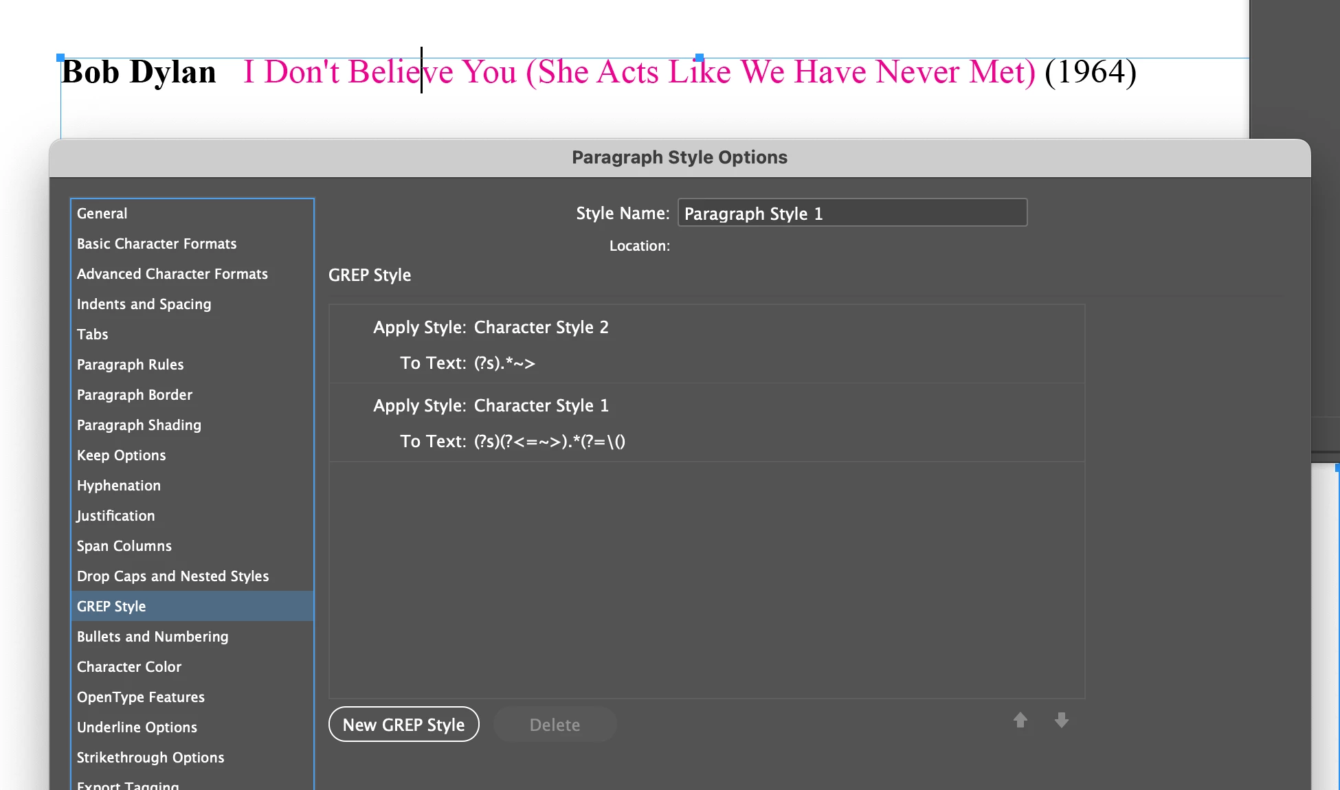

You have used lookbehind in (?s)(?<=~>).*(?<=\()
Doesn't this (?s)(?<=~>).*(?=\() work for you? Seems to work for me, see the screenshot.
-Manan
-Manan
