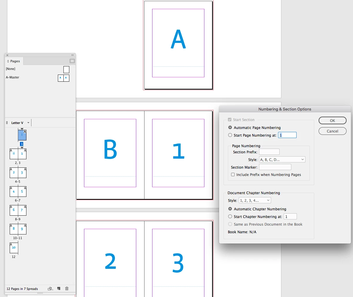

Hi Peter:
I'm not clear on your question. Are you asking how to restore normal page numbering? 1, 2, 3, 4, 5, 6?
The key to understanding page numbering (either to restore the original sequence or to change it to something else) is to understand the little gray triangle above the body page icons in the Pages panel.
Note the single triangle above page one, and the normal numbering sequence (left), vs the two triangles (right). The first one indicates roman numerals, the second restores arabic numerals.
If your goal is sequential numbering, double click each triangle and uncheck Start Section. If your goal is to change the page numbering from what you see currently, right click the page where you want the numbering to change and select Numbering and Section Options. After you make the adjustment and click OK, the triangle will appear.
~Barb
peterr82291792
April 20, 2018
Hi thanks for the quick response.
Attached is a screen grab of how my current pages look in the pages panel. My page numbers needs to start with pg 1 on the indesign page 3, but the pages before this are numbered 3 and 4, but I also have 3 and 4 after my numbered pg 1. Not sure how the first 2 pages should be numbered pages 3 and 4 doesn’t make sense to me.
Should I have sections so it goes 1, 2 and then starts again 1, 2, 3, 4 ect. And if so how do I do this.
Hope this makes sense.

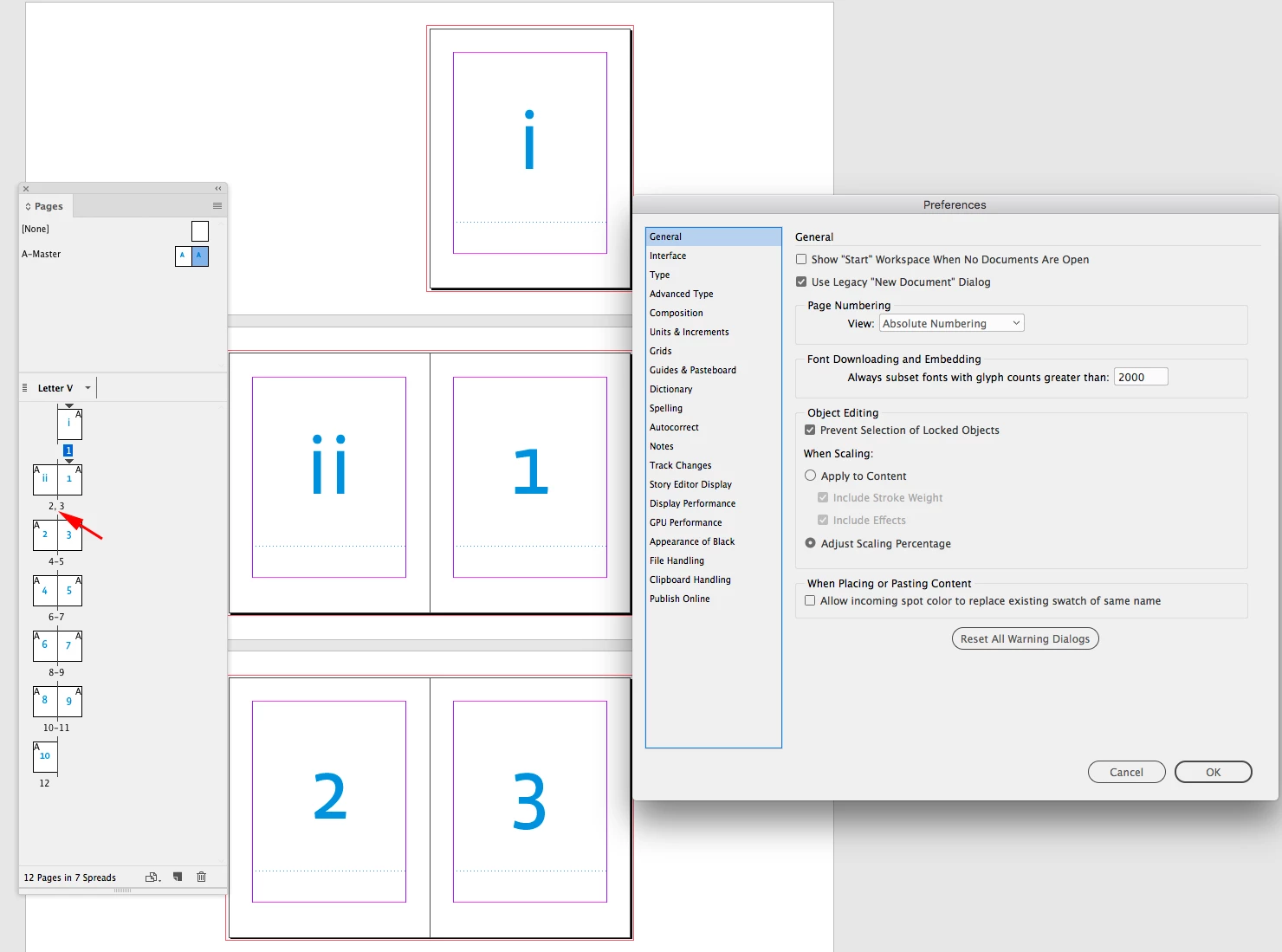

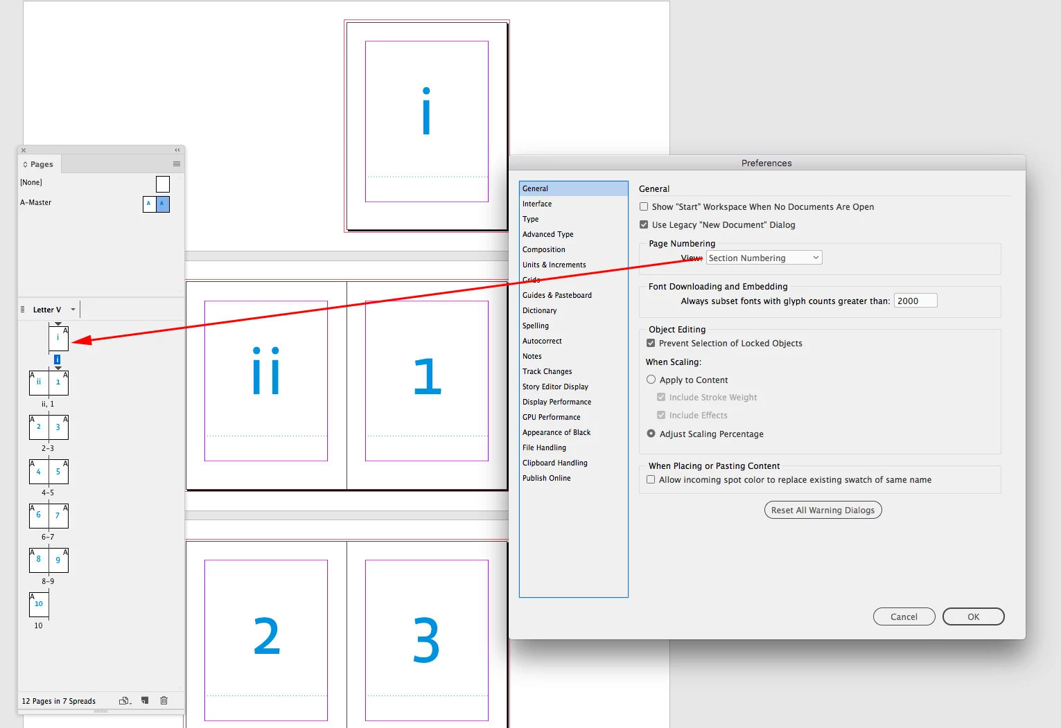

peterr82291792
May 30, 2018
Also, in case you haven't noticed there is the Page Numbering preference that affects the Pages panel display without changing how the auto page numbers work. The default Section Numbering reflects how you have set up any sections in the panel page icons. If you don't want that visual cue, you can set it to Absolute Numbering without changing the page auto numbering characters.
Absolute Numbering uses a comma to indicate a section change but keeps the panel's numbering absolute.
With Absolute Numbering I can still edit the section style and it will be updated on the pages
