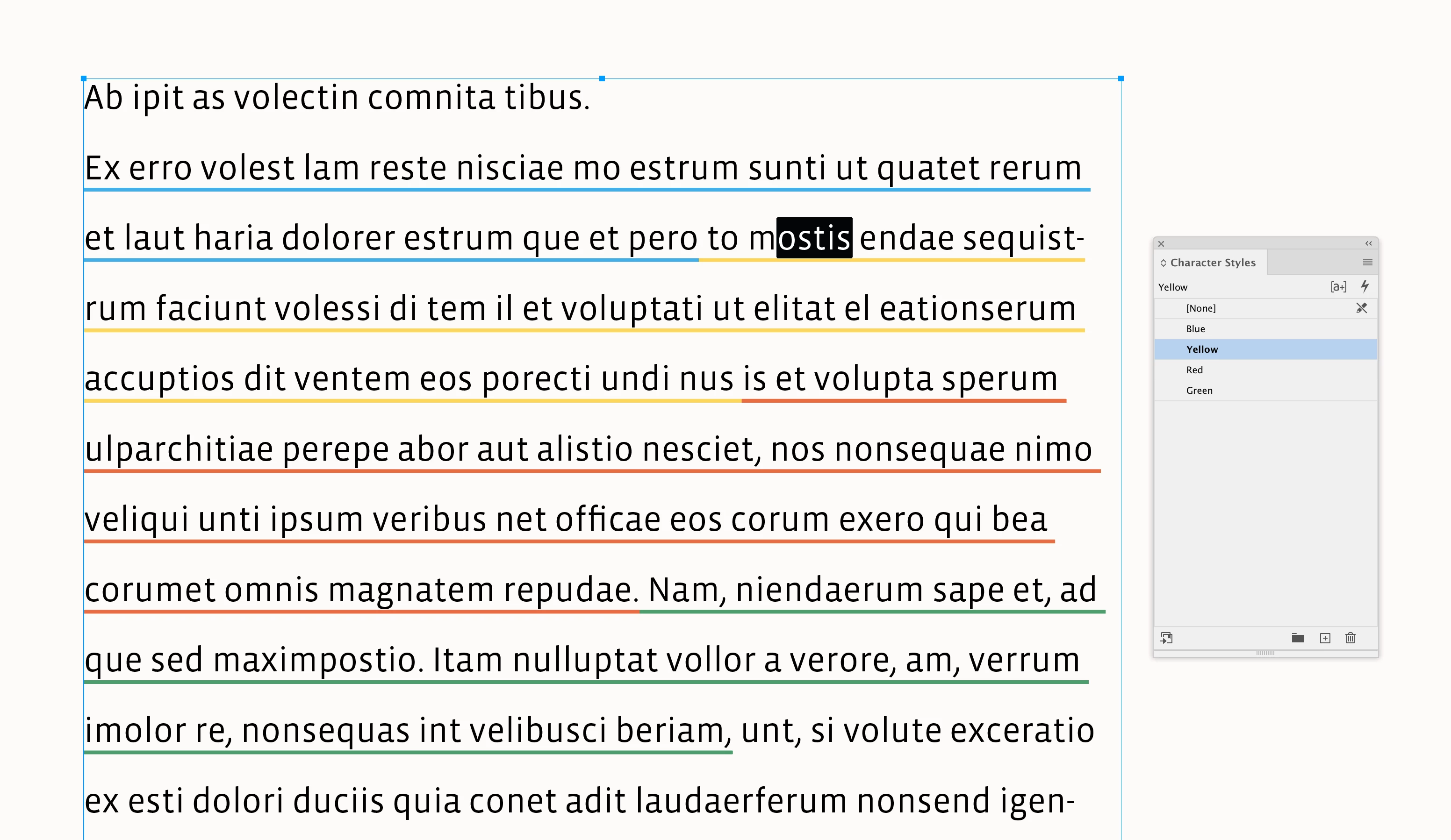

Jul 15, 2025 1:21 AM UTC
Hi @pino_2179 here is a screenshot showing the standard underline options available. You can adjust colour, thickness, offset and also choose from some preset line types. Maybe they would help in your case?

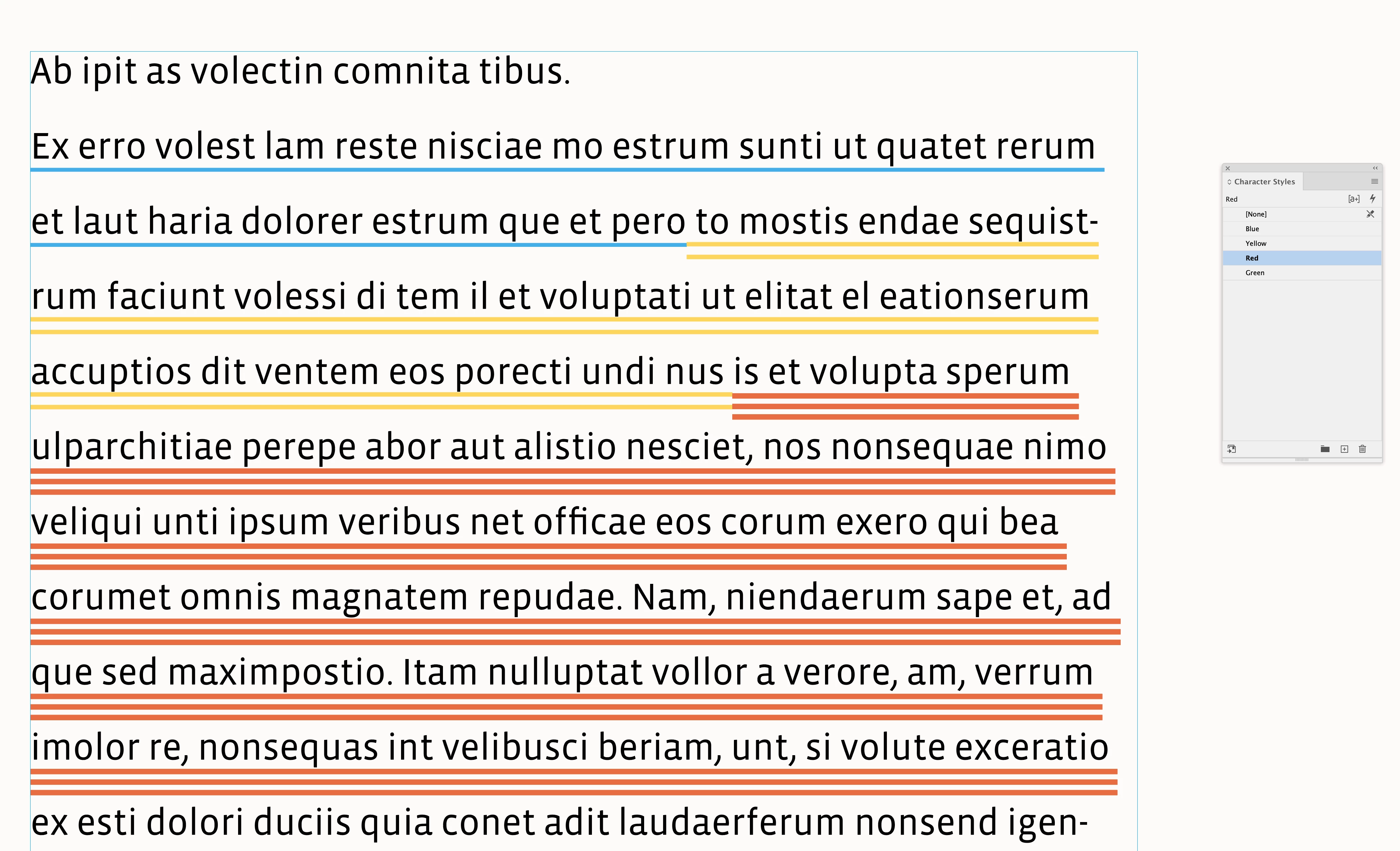

Okay @pino_2179 I don't think any of our options will work because Indesign cannot apply multiple coloured underlines to the same text so where the black and green overlaps is a problem.
We are going to have to think outside the box on this one. I have some ideas but they all involve scripting.
