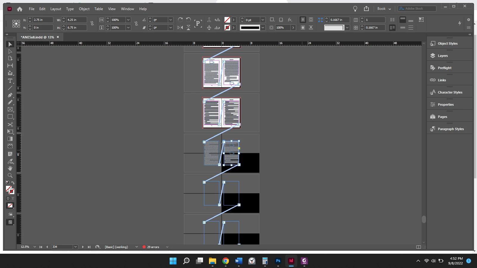

My pasteboard has split in sections
  • September 8, 2022
  • 336 views
My pasteboard seems to have split in four sections, and it's, in turn, not showing the text in all the text boxes. It doesn't look like I have an alternate layout set up. You can see that most of the document is set up to the standards I need (the regular white pages against the non-split pasteboard).
I'm not sure what I did to trigger this happenstance.

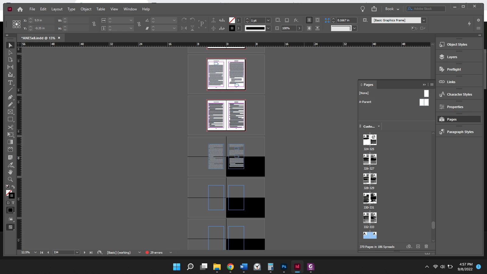

The Goth Editor
September 9, 2022
Here is an image of the pages panel for reference.
