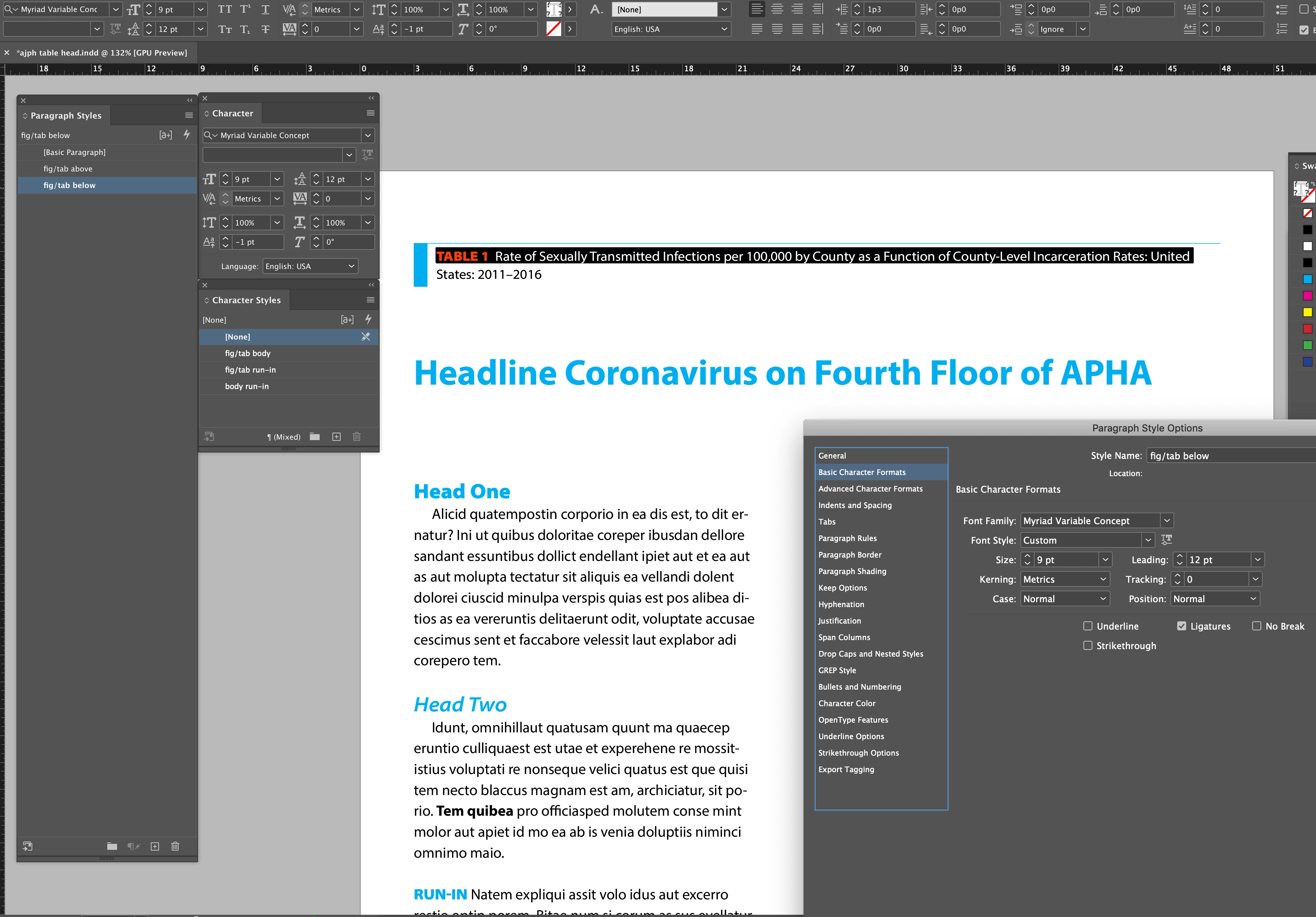

I've created several styles utilizing standard and custom instances of Myriad Variable Concept and applied them to my document. The problem is that none of it prints. When I use the same instances in Illustrator there is not problem.
Has anyone else run into this issue and is there a solution?

HI,
Can you describe a bit more clearly what you are trying to achieve?
Can you confirm if I got this correctly:
  • You are designing a layout in InDesign
  • You are using Paragraph and Character styles using fronts from the Myriad family
  •  You are using variables? (if this is the case, can you specify which ones?)
  • When you print, your design is not appearing on paper
  • When you use the font called Myriad in illustrator, it prints correctly
Please include a screenshot of your InDesign screen with the Layers and Styles panels opened.
What colour do you use for your styles?
Alan-freeAuthor
February 28, 2020
You have understood correctly--on screen things look as they should but, when I print, nothing styled with any instance of Myriad Variable Concept comes out...
