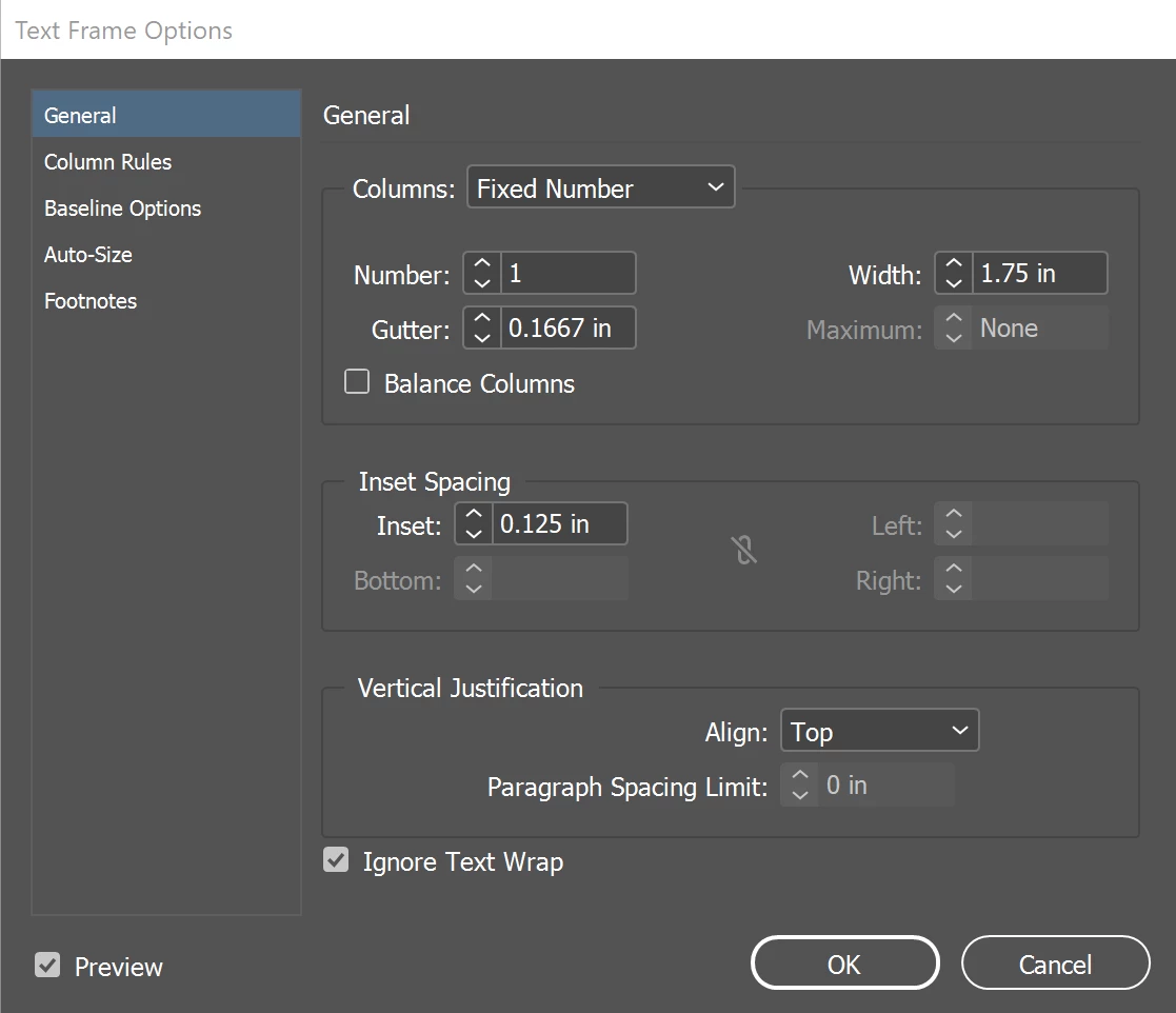

So OK. I did not realize or think about editing the shape of the frame. That works except I need to reduce the spacing at the top some, but as you see below, it is constrained to a single spacing for all sides. Surely I can change that, but I cannot figure out what is causing it to be a single setting.
