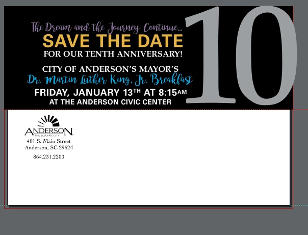

We're a printer, and generally we can manage overprint issues, but this one has all of us completely stumped. (No judging the design, we have little control.)

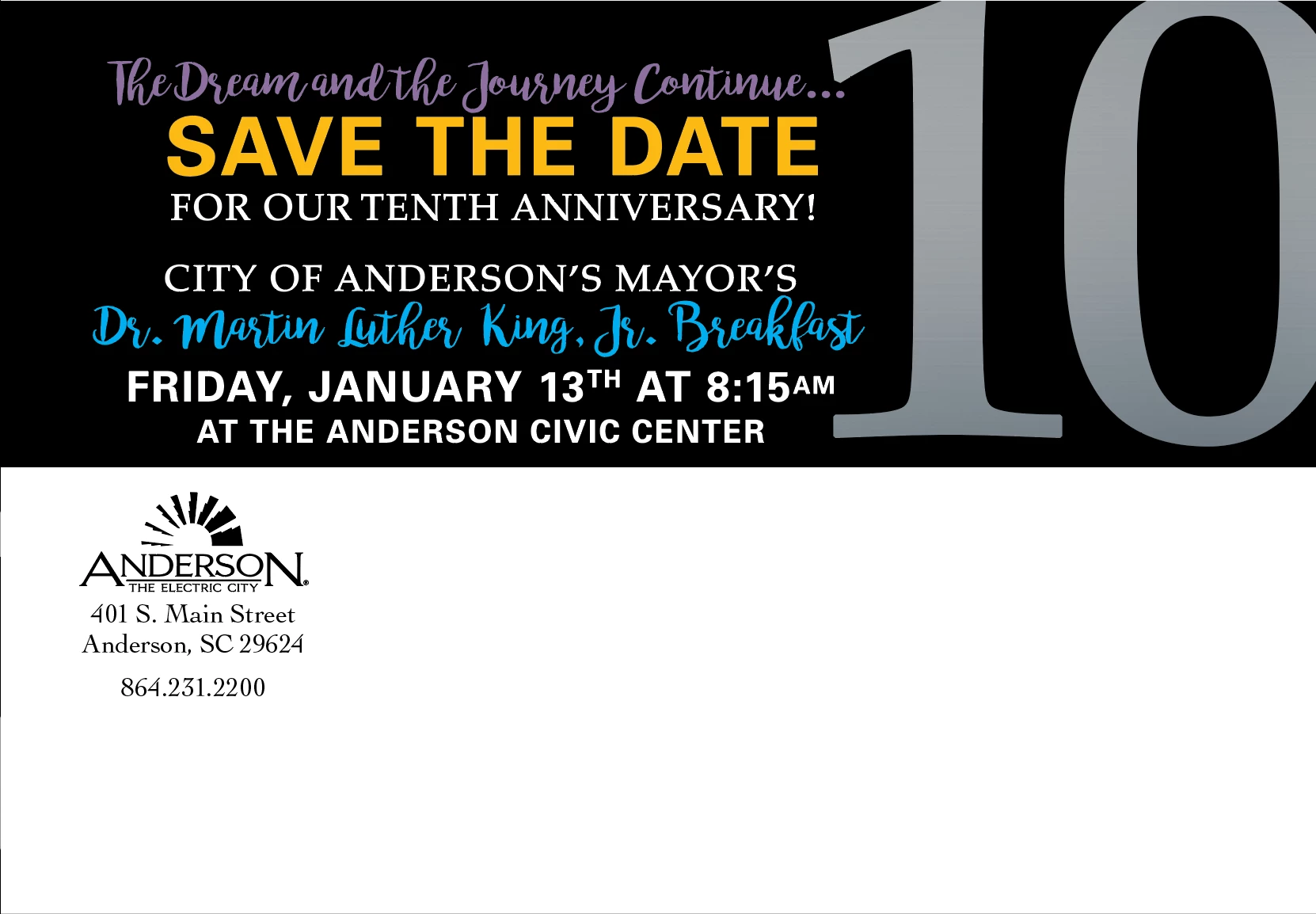

The blue line of text in the image below will not print. It's Process Blue, no funny spot colors, no effects, no shadows, and no font errors. It's one line in a text box full of other text that prints fine. It disappears in the Overprint Preview but gives no errors in a Acrobat Preflight. I've done the Object Search to find anything set to "Overprint" with no results, I've checked our black overprint settings, I've printed from pdfs, I've made outlines of the text, and I am completely out of ideas.
The same color swatch printed fine on the front of the cards... and the background is rich black - we converted it from 100%K hoping it would help. It did not.
Please help me before I throw my computer out the window.

    There could be a character style applied to the blue type, with the character style set to overprint, although that should be indicated in the attributes panel (window> output> attributes), if just the blue type is selected.

    My guess is, that the creator has done this text in black in Illustrator (or even in InDesign itself), after that converted to outlines (which should never be done). Therefore the new object inherited the overprint property of black and after that he changed the color to blue.
    If it is an InDesign object (open paths in InDesign), select it and change the overprint attribute to no, if it is an Illustrator file, open it there an do the same in Illustrator.
    Blue-overprint becomes invisible in rich black as it here.
    Later you have to educate your client that outlining fonts is NEVER a good idea, as this is one of many reasons why it should never be done.

    A placed link with overprint does not show up as a preflight error in Indesign. The fact that it disappears with overprint preview, sounds like it's a graphic, And would need the overprint turned off in Illustrator.

    You didn't mention it in your post, but I assume you've selected the cyan text and checked the Window>Output>Attributes panel? Is it native text or a placed link?
    December 1, 2016
    It's native text. No attribute issues to be seen - but the other text in the text box is displaying correctly.
