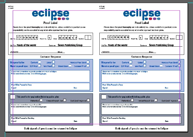

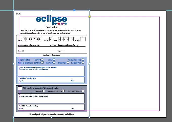

So at my work we use a type of label on all our jobs but we do two at a time.
So I am trying to make a script that dupes up the ticket and moves it across to fit.
But Im extremely new to scripting and I don't know where to start so I was wondering if anyone has any pointers to put me in the right direction?

This would get you started though based on selecting the initial item
you would have to do more work to get the page to fit etc...
var item = app.selection[0];
item.move([0,0]);
var newItem = item.duplicate();
newItem.geometricBounds = [item.geometricBounds[0],item.geometricBounds[3],item.geometricBounds[2],item.geometricBounds[3] + (item.geometricBounds[3] - item.geometricBounds[1])];
newItem.fit(FitOptions.PROPORTIONALLY);
