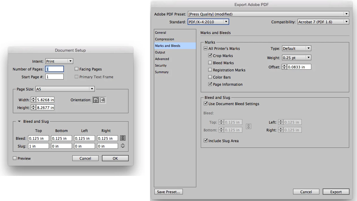

Almost all printers need some blank space on the edges for their grippers so your art will have to be printed on larger stock and then trimmed using crop marks to size. This allows you to add bleed to your art. A document that is to be printed on two sides should contain both sides in a single InDesign file as well as for the pdf that you are sending to the printer.
When you set up the job set the trim size to A5 and your bleed to a minimum of .125 inches. You can also add a slug area (a blank space outside of the bleed) to give the pdf some breathing room (left picture above). When you set up your export to pdf make sure that crop marks, page information, bleed setting and include slug are checked as shown above right.
Of course all of the settings I've listed will need to be confirmed with your printer, I only include them here as a general guide. Email or call the printer to confirm the information I've given. Printers appreciate being asked questions. It saves them lots of headaches down the road.
