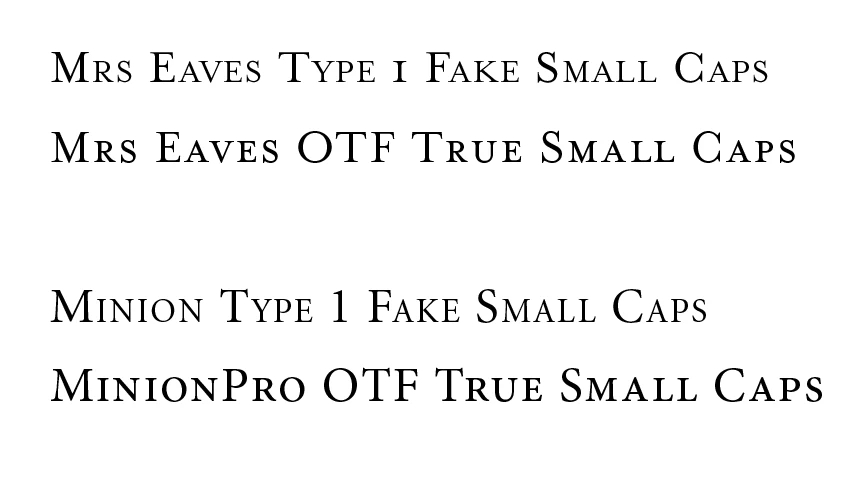

    If you really want fake small caps—small caps that are not drawn to match the capital’s weight & width—then don’t use an .otf font.

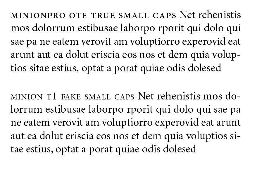

    Usually with .otf fonts the true small caps are included with the font and are used when you spec Small Caps either as Small Caps or Open Type>All Small Caps from the Character panel.
    True small caps normally are preferred because they match the font’s weight when are mixed with upper and lowercase text. Here the T1 version’s small cap appears to be a lighter weight. In high resolution print the weight difference becomes more obvious.

    I think you‘ll have to use TT or T1 fonts, or avoid the Small Cap spec and make a custom Character Style that sizes capitals. The point of OTF fonts is to fold true small caps, full ligature sets, number sets, etc. into a single font—they are not limited to 256 glyphs.
