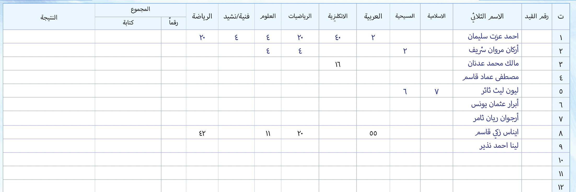

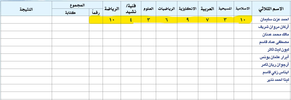

I'm a school Manager and I need a script to sum a degrees in a certain Table
I have these numbers in a row and I need a script to sum All numbers in certain row and put the sum degree in last blank row
Sorry for my bad English

Edit 2024-11-19: changed script because my original script did not work with OP's demo document. The following is updated answer:
Hi @alma_3660 I have updated the script to work with the demo document you gave us. I hope it will be useful now.
To use it, make a selection of table cells (one row or many rows) and run the script. It will put the total for each row's cells into either the first or last cell on each row (you can adjust this in the script).
Let me know how it goes.
