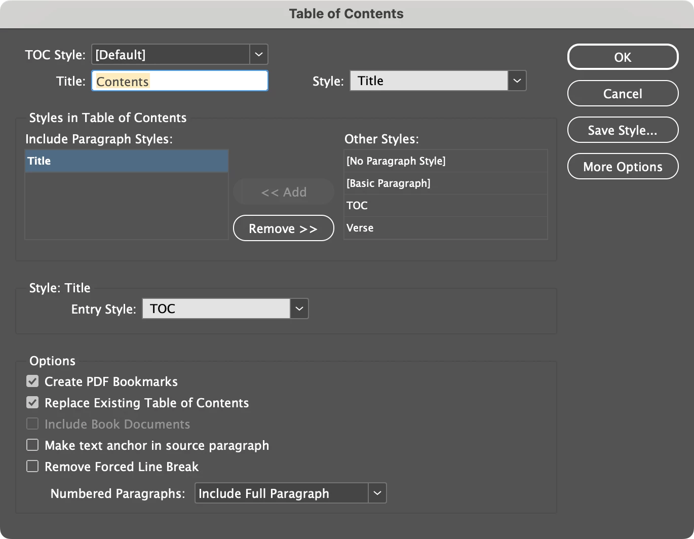

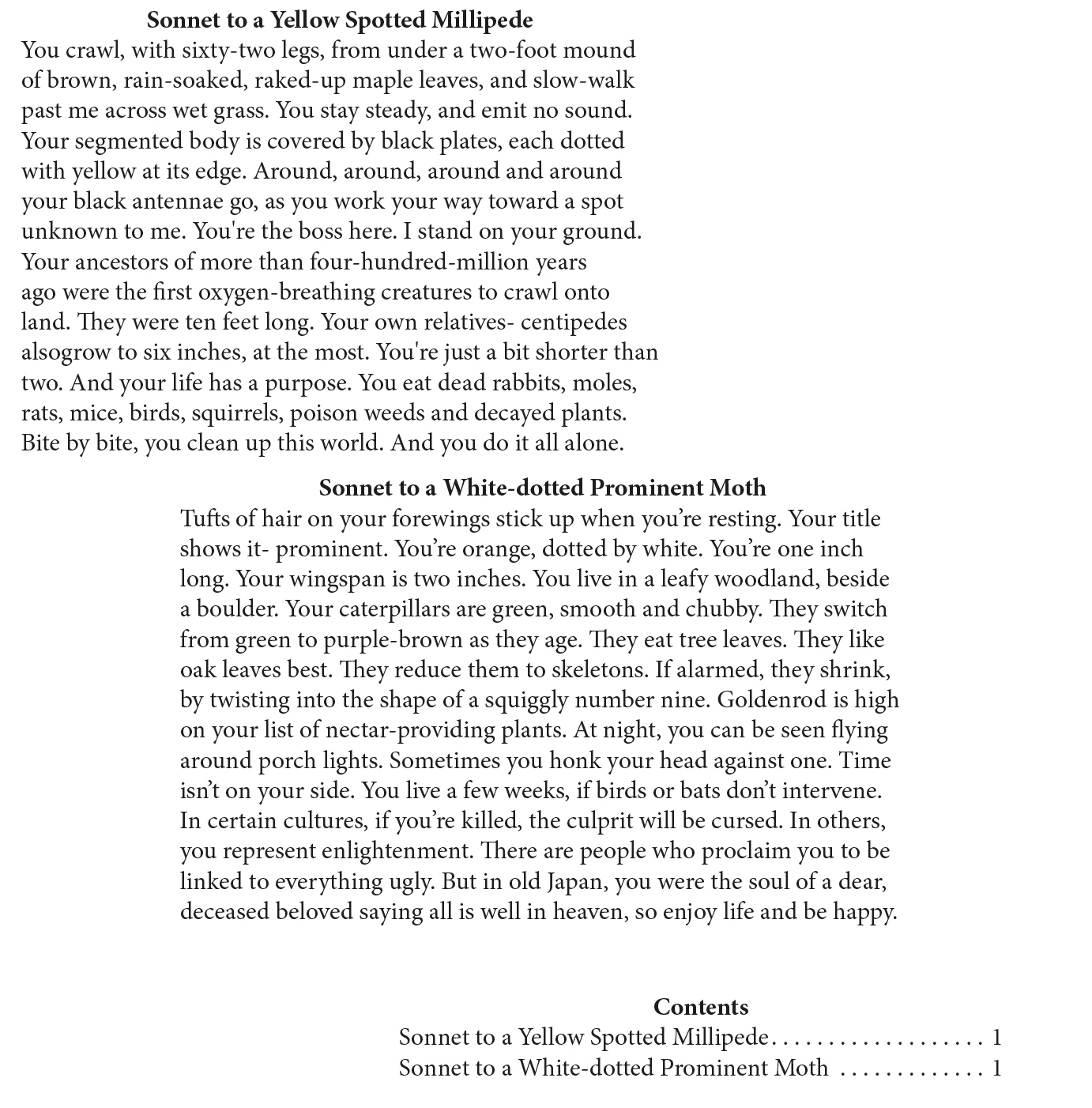

Hi. I'm formatting a book of poems in InDesign. The content consists of 582 poems, with 2 poems per page. The poems run straight through the book, with no sections, chapters or headings, only page numbers. Each poem's title is boldface Times New Roman, size 12 (sample page attached). I'm having trouble making a TOC, especially since this is my first TOC. Can someone advise me, please? Thank you. -- Clare

You need to have a paragraph style applied to all the poem titles, and only to the poem titles. It also helps to create a paragraph style for the TOC entries. Make a faux entry with title and page number then set the style, margins, and tabs as you want them. Make that a paragraph style then use that for the TOC entries. Your TOC setup might look like this…
The results look like this…

As @James Gifford—NitroPress said - it would be straightforward IF you have ParaStyles applied to the poem titles.
If you don't - then you need to use Find&Change to apply them.
In Find What set formatting applied to the titles, in Change To select ParaStyle that should be applied - leave text fields Find & Change blank.

Thank you very much. It's okay. I applied a style to all the titles before I started the TOC. I then tried to do a TOC and it did appear, but it started on page 12. Plus the titles of the poems were aligned perfectly to the left, but the page numbers not all aligned. Should I just use the tab key to line them up, or is there a better method? And do you have any idea why the TOC started on page 12? That one really threw me. -- Clare

In order to have page numbers aligned - you need to define new ParaStyle and use it when generating TOC - and set TAB stop accordingly in this ParaStyle definition + align right - you can also add leading dots.
https://helpx.adobe.com/uk/indesign/using/tabs-indents.html
