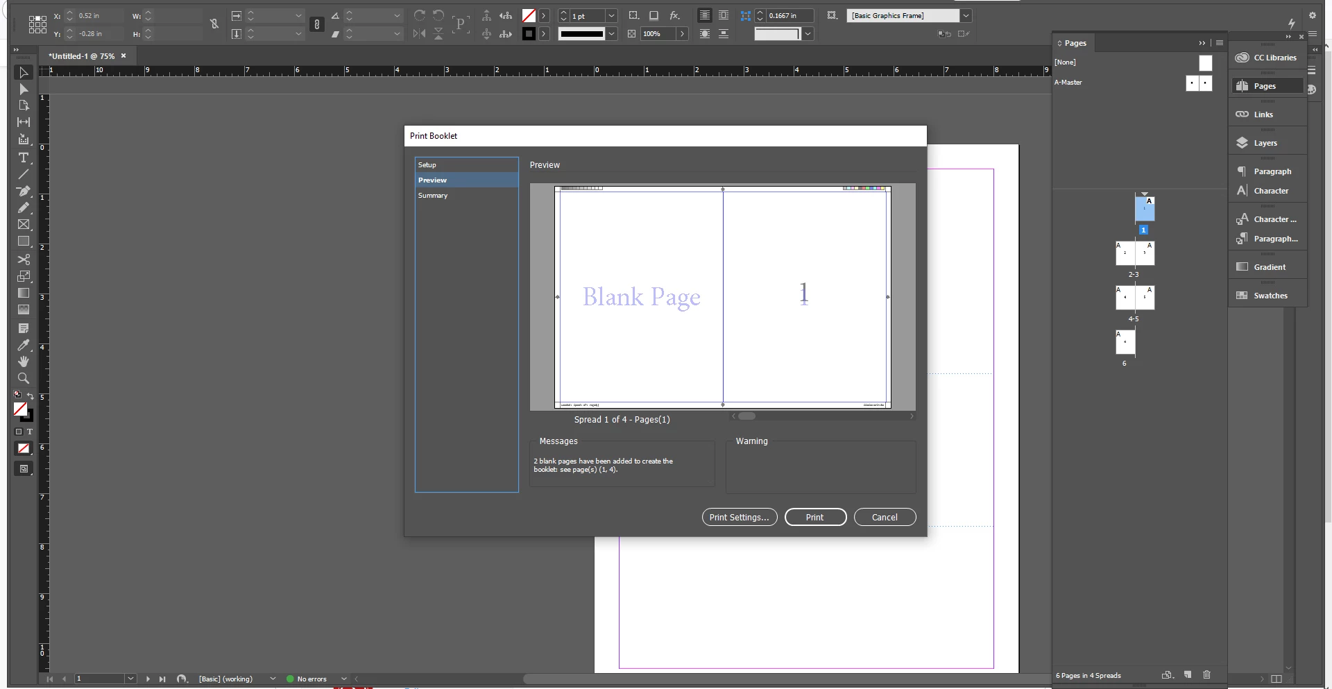

Hello, I need to impose a booklet layout from my reader spread created in Adobe Indesign. I am using the current cloud version of Indesign on Windows 10. I have tried the print booklet feature and it does not work. When I run a preview, the program inserts a blank page to the left of page 1 and also inserts and extra blank page after page 2. I have also tried in Adobe Acrobat with the same result. Every help article and video I've seen so far is not helping. The result I need to achieve is to print the front and back cover next to each other and other (letter size) pages in the right order on tabloid size paper which will be folded and saddle stitched.

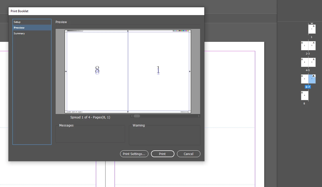

Thank you Bob. That worked, I did not see earlier that you need multiples of 4. Im adding this screen shot so maybe others with the same issue will see.
Thank you!
