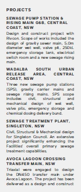

Needing help to re-design my document from 34 pgs to 36pgs with tricky design layout
The InDesign files were originally for online only, not print, and as such, were set to 34 pages.
We now want to print it, and it needs to be 34 pages.
The design has been set up in a way that each page blends into the next, so adding two random pages will disturb the layout.
I think adding one at the back should be fine, and will not disturb any layout, but adding one at the front will throw everything else out.
How can I add a page at the beginning (front), to get to 34 pages, to fix this, and make it work?
“Document attached for reference”
Your help would be appreciated. Thanks
