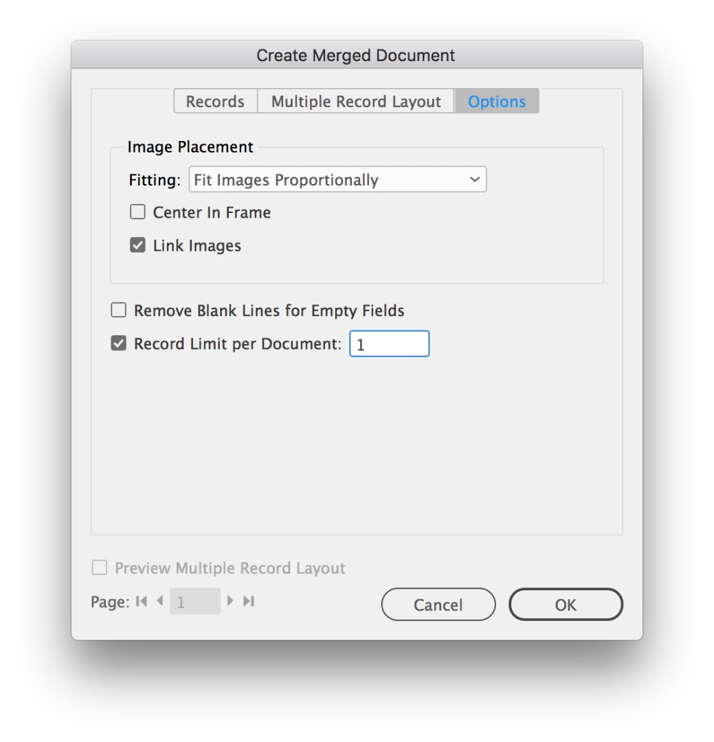

My organization produces a quarterly newsletter in-house that generally is from 32-60 pages. Ledger-size paper folded and stapled into a booklet by the printer. We've been using MS Publisher, but want to move to something that will make an easier transition/sharing of content in other ways, such as on our website and social media, so InDesign seems like it might be a good fit.
But, we'll still need to print the paper version (roughly 600 copies per run) for the foreseeable future, and we're doing that now (from Publisher) by directly printing using Publisher's mail-merge function, such that each copy printed has the name, address, and USPS postal barcode information (for bulk mail presort and bundling).
From what I can see, so far, InDesign wants to generate multiple PDFs, which would then get printed individually. Is there a way to print directly from InDesign, using a data source file for the merge information, similar to how we're doing this now with Publisher?

Data Merge can merge to either a new InDesign file or PDF. Using InDesign alone, there is an option to merge to individual InDesign files (i.e. one record = one InDesign file) or this range can be increased using the "record limit per document" in the create merged document dialog box. The same dialog box exists when exporting to PDF but the record limit per document doesn't  work for this export method.
