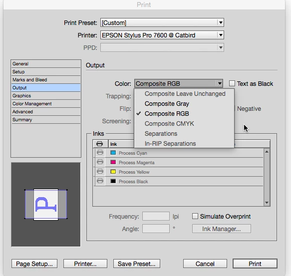

Why can I select composite cmyk color option when printing in indesign CC? There're only options for Composite RGB or Composite Gray and nothing else. I tried to uninstall the old version and updated to CC but the problem is still there. All the Adobe software in my MAC have this problem. I don't think it's printer's problem because I tried to print on both and none has this option. Does anyone know why? Please help!
Correct answer rob day
It depends on the print driver. Many non postscript RGB drivers will only take RGB and the conversion to the printer's space happens on output So here's Epsons RGB driver vs. a third party RIP:

Most of the statements in the post you are replying to are not true.
The answer that is marked correct is actually correct. The original post is from a person who was printing to a desktop inkjet printer (not a printing press), which uses software that expects RGB data to come in, not CMYK. Therefore InDesign is setting up the job as the printer driver allows. It would be wrong to send that printer CMYK, because the printer uses more than 4 inks and therefore sending it CMYK would not take full advantage of the printer. Sending it RGB data provides for a larger original color gamut, which is then converted to the larger gamut that the inkjet printer’s 8 or 9 inks can reproduce.
Now, you might actually be working on a job that is only intended to go to a CMYK press in the end, and therefore it is best to specify all the colors in CMYK. Maybe you want to do a “hard proof” on a desktop inkjet printer to check the colors. That is possible to some extent with the printer’s own driver software, but to do things like preview halftoned CMYK separations (which most people shouldn’t actually have to do), you should have the printer emulate the final platemaker as closely as possible. But to do that, you need extra printer emulation software. That is what Rob Day was talking about when he mentioned a “third-party RIP” (raster image processor). If you set up one of those, or if you are actually hooked up to a CMYK output device, then InDesign will present CMYK options in the Print dialog box. InDesign is only doing what is correct for the way the printing pipeline is set up.

rob day
rob dayCommunity ExpertCorrect answer
May 3, 2017

rob day
May 12, 2017
The CcMmYKk inkset your Canon printer uses has a considerably larger color gamut than standard offset press inks, so to take advantage of that larger gamut the driver expects composite RGB and the driver makes the final conversion into the printer's profile. Usually RGB drivers do better if you send RGB images and colors.
The iProof RIP I'm showing in my capture can output actual document CMYK values, but typical offset profiles like the default US SWOP Coated don't work in that case because the profile of the printer doesn't resemble offset at all.
Steve Werner
May 3, 2017
What kind of printer are you printing to? Please give exact make and model.
taylor_n308
May 12, 2017
I'm using Canon Pixma Pro-100 and HP OfficeJet 4650
