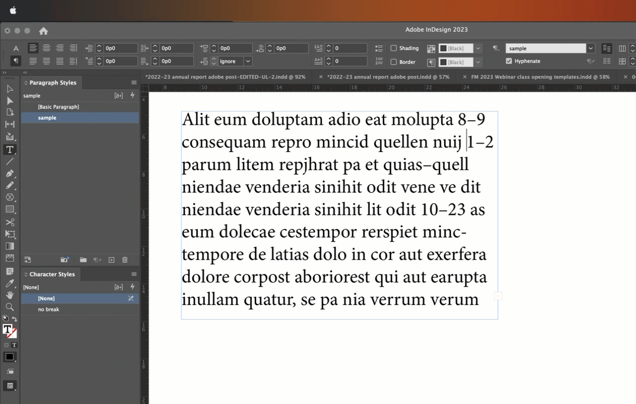

Hi @YvonneB837:
I'm curious how you are using the en dash. An en dash should be used between ranges of numbers to represent the words to or through. For example, tonight's homework is to read pages 23–28. See https://www.merriam-webster.com/grammar/em-dash-en-dash-how-to-use.
How are you using it? I'm asking because I'm having a hard time setting up an example. InDesign keeps the numbered range together and I can't get it to break. If it use it between words, it will. In the example, below, as I edit the numbers, they move together to the next line. If you are using them between words, you can create a GREP style and assign no break to an en dash and it will take care of it as you see on the words quais–quell.
~Barb

Hi @Barb Binder,
I am using the en dash for number ranges, just like in your example. I have been struggling with getting the en dash to work, but I am glad to say that I have finally solved it. For periods and slashes, it worked to only apply the 'No break' setting to the period or slash, but this was not working for the en dash. However, in the end I figured out that it does work when applying it to the entire number range.
Your example got me thinking (and frustrated), but it helped me finally solve the problem, so thank you!
