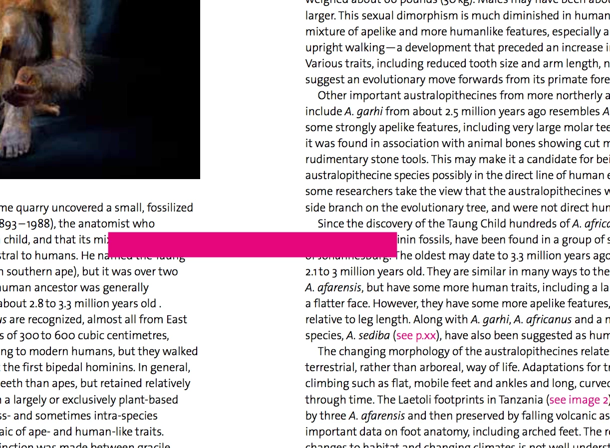

I changed no settings whatsoever and it stopped doing it, my InDesign is very temperamental it seems.
I still have the broken PDF though so here are screenshots, I think it's almost certainly a glitch though

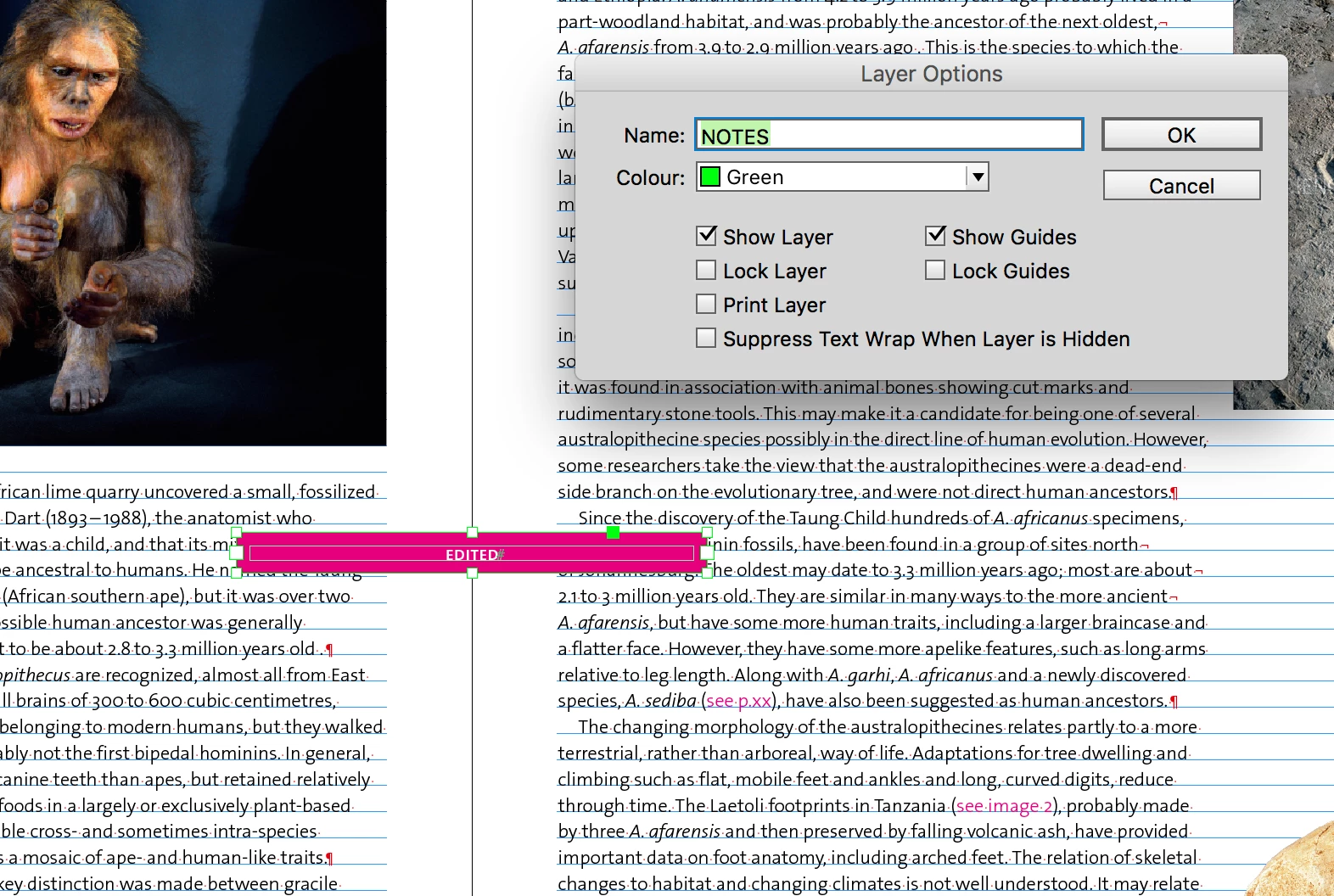

How are you setting the items to be non-printing? Are you setting the Layer to Not to Print or the object using the Attributes panel?
This can make a difference

Sorry, I should've been more specific. I'm setting it using the layers panel, I'm using InDesign CC 2015 and I'm on Mac OS Sierra. I should also state that the stuff on the non-printing layer is exclusively coloured text boxes and while it prints the coloured box, it doesn't print the text. I'll get a screenshot if you still need it.

How are you setting Non-printing? In the Attributes panel? In the Layers panel? Show us a screen capture.
Also tell us what version of InDesign you're using, and your operating system, thanks.
