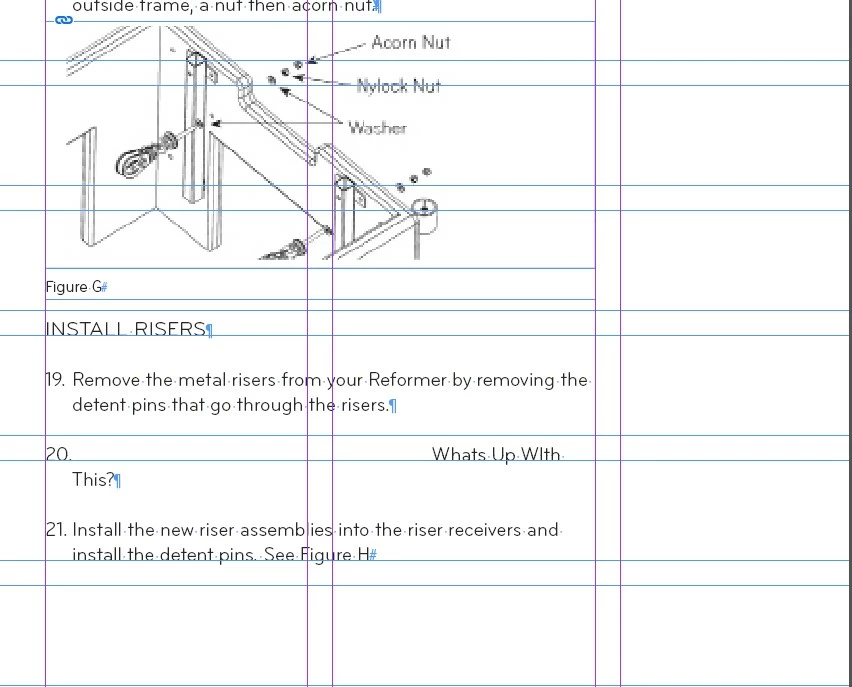

I have a document with a numbered list. For some odd reason when the list increments to 20, I'm seeing a big increase in indentation. When it increments to 21-29, it returns to normal (13, -13) but at 30, I see the increase in indentation. It doesn't happed at 10 - only 20, 30, 40, etc. There is nothing there like a shape with text wrap. I tried different left and 1st line indent values including zeroing them out, but nothing changes the bevahior. I tried creating a new paragraph style but still end up with this. I created a new text frame off canvas and each time I get to 20, 30, etc. i see the same thing happens. I tried swapping out fonts - no go. Any help would be grateful.

Chris Panny
Nov 18, 2025 11:47 PM UTC
Thanks for your comments. As you can see in my 2nd screen, there is no value in the tab position. However, when I added a tab value, starting at 1pt, I kept incrementing it. I wasn't keeping track but I believe when i got to the equivilent indent value, the problem corrected itself, but the tab value was also cleared out. Although this fixed it, how come InDesign is flushing out the value so I can't see it anymore? I know it's in the Tab section of the paragraph style, but it's odd it's not listed in the bullet list.

Dave Creamer of IDEAS
Nov 19, 2025 1:12 AM UTC
The blank tab setting is when InDesign automatically sets the tab setting. Whenever one sets a left indent and then a negative first line indent, InDesign automatically sets the tab.
Nov 18, 2025 10:20 PM UTC
If a tab can't fit in the space alloted (13 pts in this case), it will jump to the next tab setting.
You must have a tab setting about 2 inches in. Check  your tab panel and edit the second tab position accordingly (or add another tab between the two existing tabs).

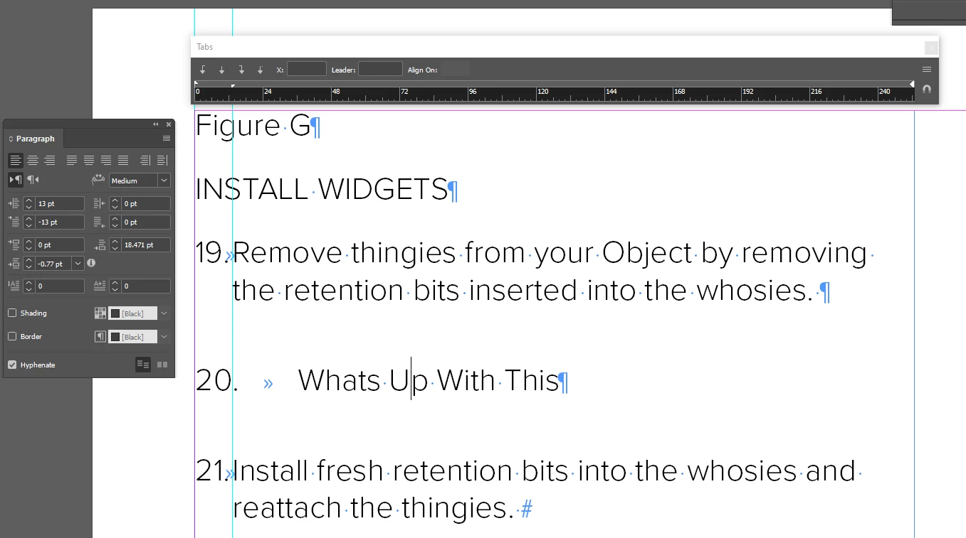

Joel Cherney
Nov 18, 2025 8:56 PM UTC
I think that the easiest explanation is that your hanging indent isn't deep enough to fit the zero, in any of the fonts you've tried. In this little mockup, note the tooltip on the guide I've pulled off the ruler - at 13 points, the depth of your hanging indent, there still isn't enough room to fit the zero and the period.
If you want to verify that it's the tab from your numbered list pushing the Whats Up, that's easy enough:
1) Make sure your Type -> Hidden Characters are turned on
2) Select all three numbered items
3) Go to Type -> Bulleted & Numbered Lists -> Convert Numbering to Text
