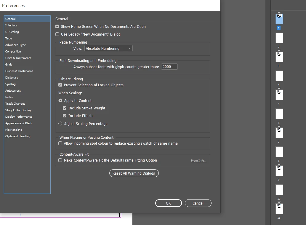

I presume that 1 3 5 are duplicates???
You can do it with Section Numbers
https://helpx.adobe.com/indesign/using/numbering-pages-chapters-sections.html#:~:text=Choose%20Layout%20%3E%20Numbering%20%26%20Section%20Options%2C%20or%20choose%20Numbering%20%26,beginning%20of%20a%20new%20section.
All the little arrows above the page icons show that it's a new section.
I changed in the Preferences to show that page numbers show in the numerical order 1-9 etc.
If showing section numbers it shows 1, 1, 1, etc. which could be confusing.
Or not - you don't have to change this - I just did it to show you.
I also renamed the Master Pages to show P1 P2 etc so it's easy to find know what pages have these master pages.
which is also in the link above.
Here's my sample
https://www.dropbox.com/s/cjjivg3vmqnzllj/Untitled-3.idml?dl=0
