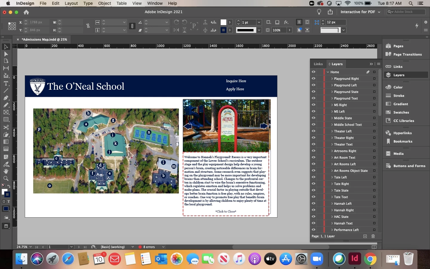

I have 17 different object states and each one has 4-5 images to click through. I built them out in different layers but once I was done, I combined them so that everything is on one layer. However, when I do the epub preview, I am only able to click through one of the object states. When I export it as an interactive PDF, I can't click any of them though the buttons highlight when I hover over them.

Can you show some screenshots with the Layers panel fully expanded so that we can see a bit what's going on?

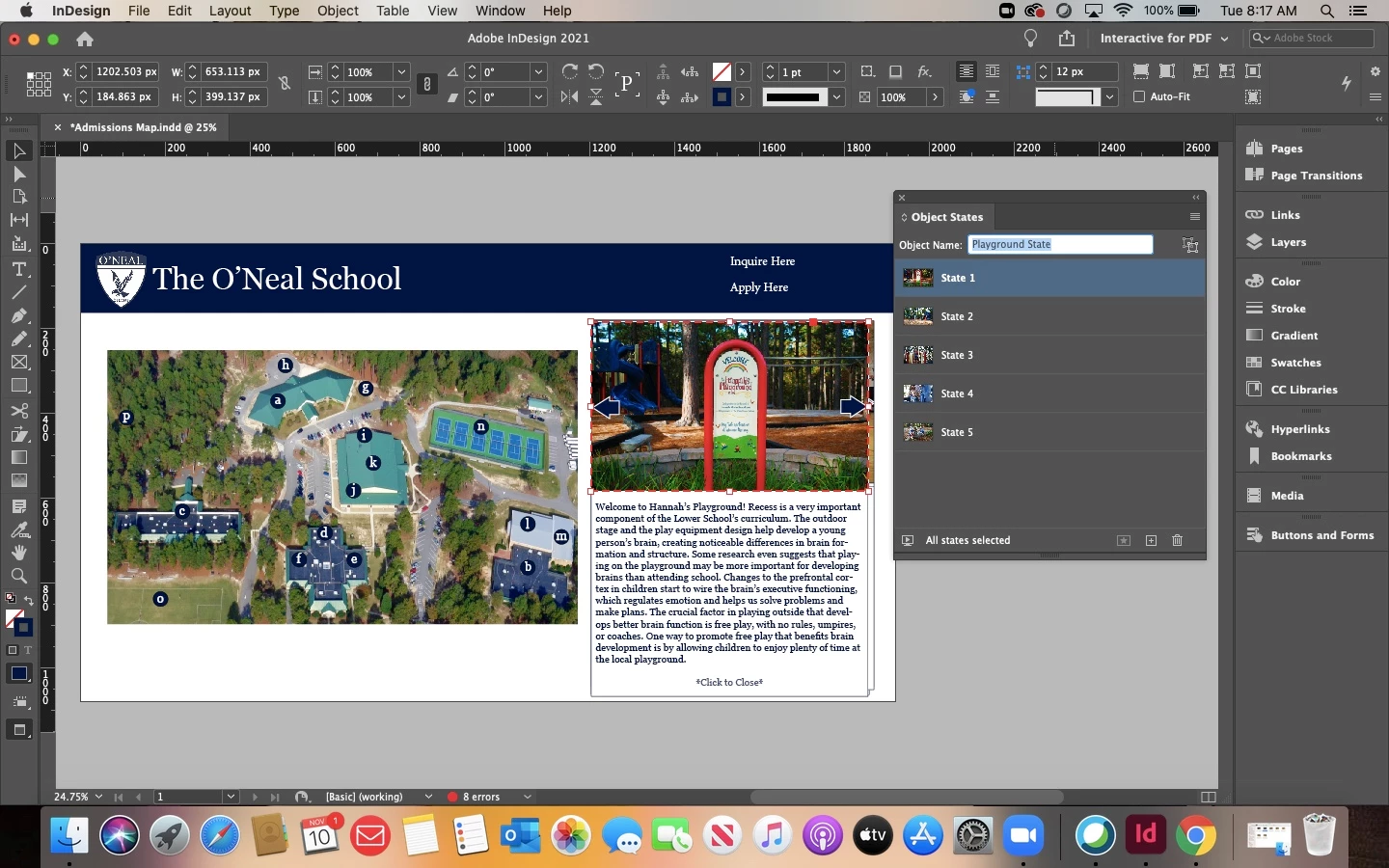

Also select one of your 17 objects and show the properties of that object with the appropriate panel.
Uwe Laubender
( ACP )
November 10, 2020
This is the first time I've used INDD so I appreciate any help that I can get. I've attached two screenshots - one of my layers panel and then one of my object state. I used the one that IS working in the epub preview
