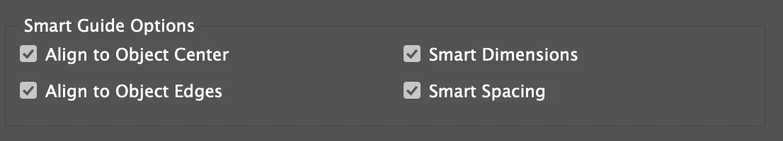

Aug 27, 2026 12:32 AM UTC
​@Abhishek Rao ​@Mike Witherell
I’ve done some further testing and have captured a video as well as some screenshots.
I noticed that snapping works for frame edges that are on the outer edge of the group, but that might be because the image is then snapping to the group edge not the frame edge.
I’m not using object fitting, but as far as I’m aware this works fine. However, snapping is necessary when you want to align only one edge of an image with the frame.
I’ve attached images of my preferences as requested.
Snapping to Document Grid is turned Off.

Hi ​@Robert32194799hqfj, thanks for reaching out, and I’m sorry you’re experiencing this issue.
I tested the workflow on InDesign 21.5.1, but I wasn’t able to reproduce the snapping behavior on my end. Could you please try the suggestions shared by Mike, particularly checking the Smart Guides options, ensuring Snap to Document Grid is turned off, and testing the relevant Object > Fitting options?
If the issue still occurs after checking those settings, please share a short screen recording showing the complete workflow, including your Smart Guides settings, how the objects are grouped, and the snapping behavior you’re seeing. That will give us a better reference and help us test the exact scenario on our end.

Aug 26, 2026 11:38 AM UTC
Hi Robert,
Under Preferences > Guides & Pasteboard > Smart Guides Options… what is checkmarked ON?
Is Snap to Document Grid turned OFF (since it fights with Smart Guides ON)?
Are you using Object > Fitting > Fit Content Proportionally (or the Fitting buttons on the Control panel) when adjusting images to fit to the edge of a frame?
