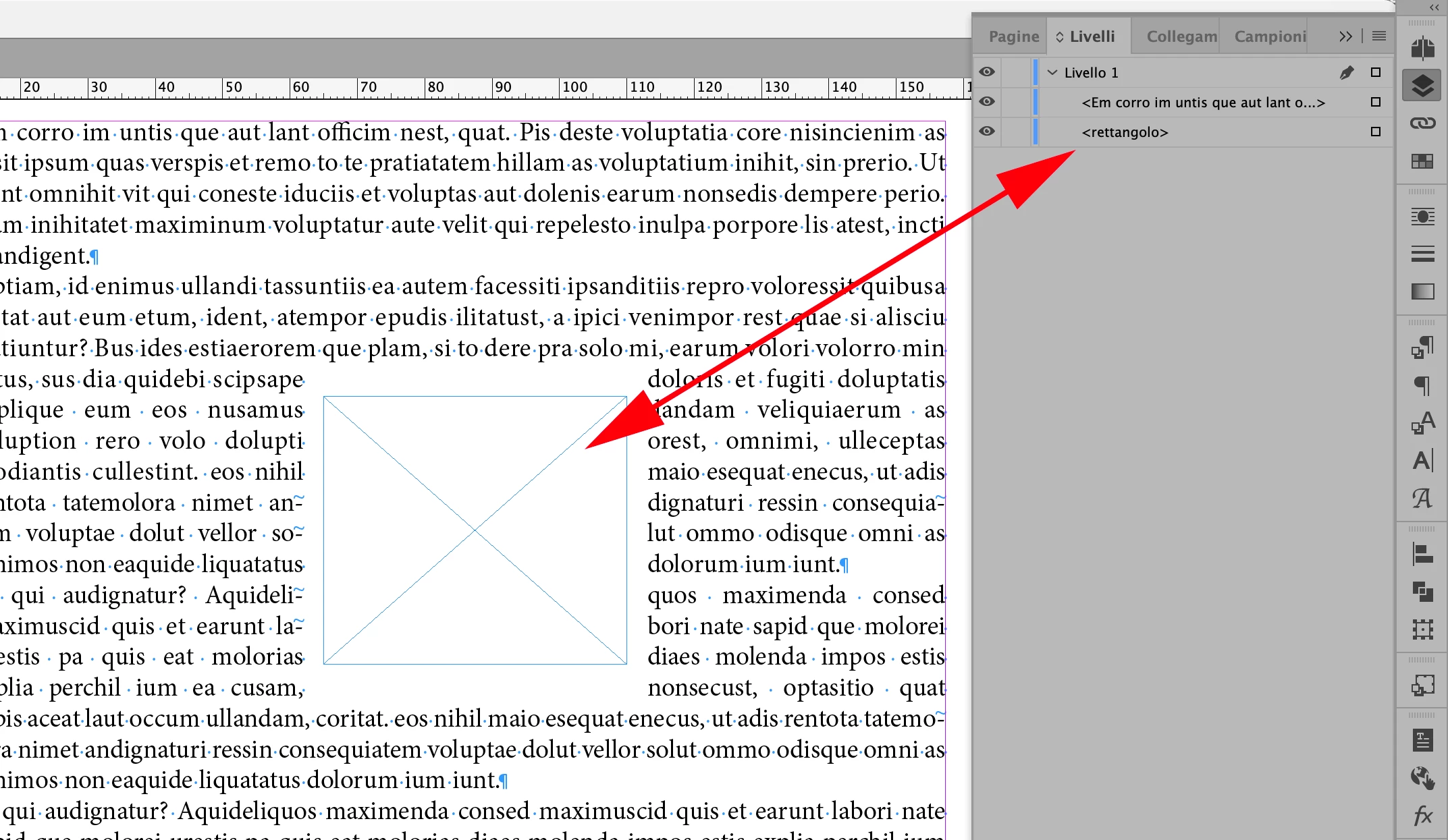

vladan saveljic
March 2, 2021
Maybe that objects are below other oblects / frames?
In my screenshot you can see one rectangle below the textframe
