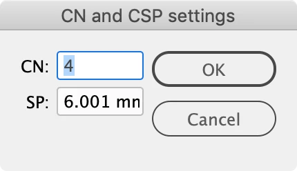

Aug 25, 2025 2:56 PM UTC
Also, not sure if it matters to you but the 2.835 constant isn’t accuratly converting points to millimeters—I’m getting this:

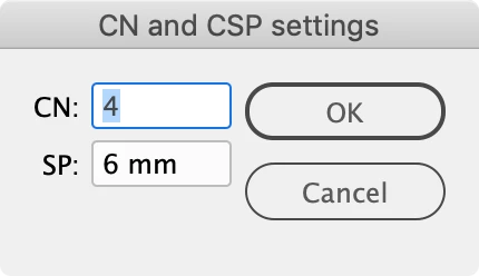

2.83465 converts to 6mm as the default:
