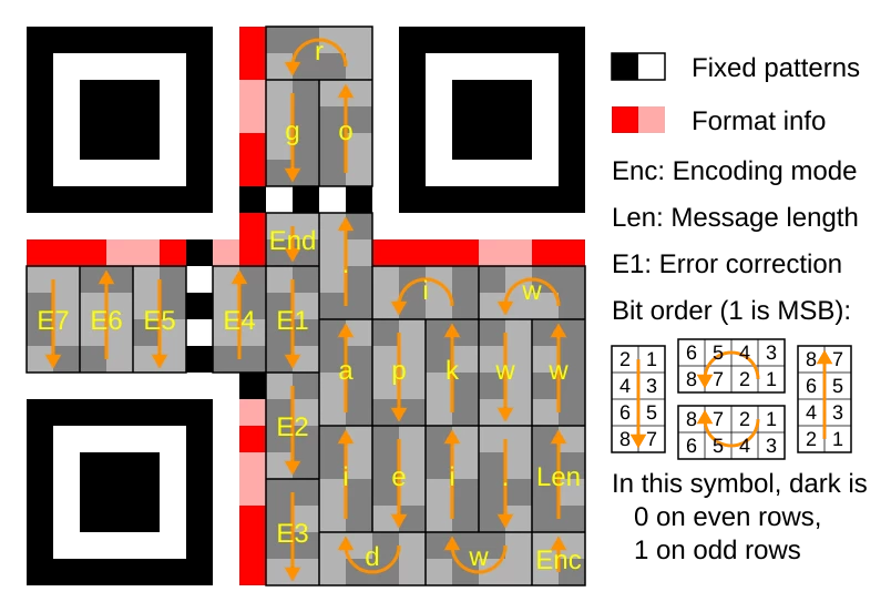

Knowing how text is stored:
https://en.wikipedia.org/wiki/QR_code#Message_placement
It should be pretty easy to "avoid" places covered by image...
