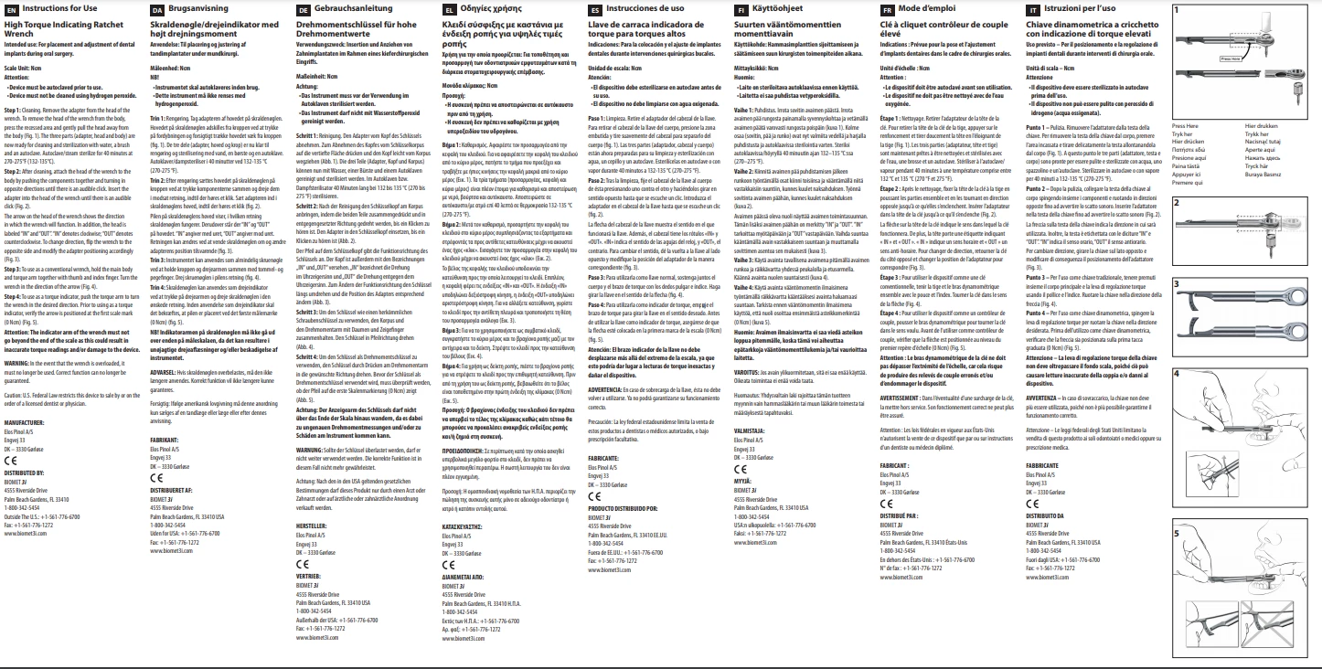

Can you show an example or two (screen captures) of finished pieces, perhaps with sample data?
Indesign's data merge can automate processes while generating variable text and images, but there are limitations. Viewing an example may allow us to determine if data merge can work for your projects or suggest alternatives.
tylerc59533517
June 8, 2021
Hi Jeffrey,
Thank you for the reply. We're interested in helping our customers generate Instruction For Use (IFU) documentation for use in the medical device industry. These are text-heavy documents with occasional images that typically look something like the image below.
