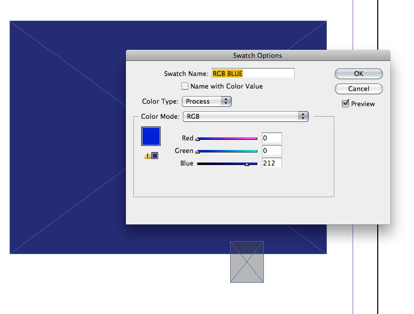

rob day
Apr 10, 2012 11:33 PM UTC

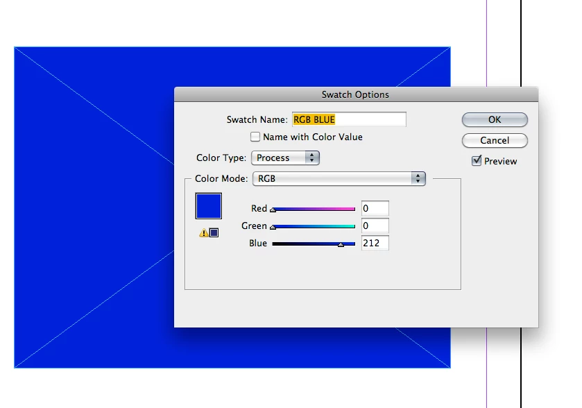

If you make an RGB or Lab swatch that is out-of-gamut to your document's CMYK space an out-of-gamut warning shows in the swatch dialog. When you use the color it will stay in the RGB gamut unchanged as long as you don't have transparency anywhere on the page with the default CMYK Transparency Blend mode selected, or you don't have Overprint/Separation Preview turned on:
No transparency, Overprint Preview off.
a transparent object on the page with a CMYK Transparency Blend space
