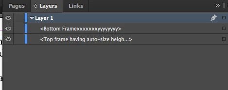

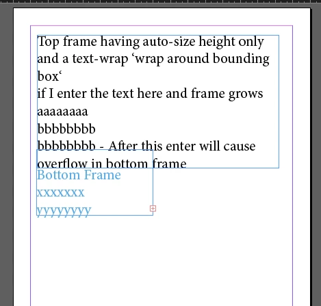

Hi All,
My test document contains two frames as shown in below image also see the layers.png
Top frame have both auto-size (height-only) and textWrap ("wrap around bounding box set")
Now when I start entering text in top frame and it grows then at some point text-insertion in top frames causes the overflows in bottom frame
Is there a way using which I can find that Overflows in bottom frame is caused by "textWrap" set on top frame.?

Hi Alam,
you would go through all page items of a spread and note all items with applied textWrap.
Then you note the value of baseline of the first line of your text frame in question. Now turn off textWrap one by one and with every time you do this check if baseline will change.
Note: It could be the case that more than one item with textWrap influences the baseline of the text frame in question.
Uwe

Hi Alam,
you could check the first line of text of the frame that overflows and its baseline property.
If it's position is not where you might suspect it the cause might be text wrap of another object.
Now the question is: Which one?
You could test all objects on the page one after another for text wrap.
Turn it off and see if the value for baseline of the first line of text in the other frame is different.
Uwe
