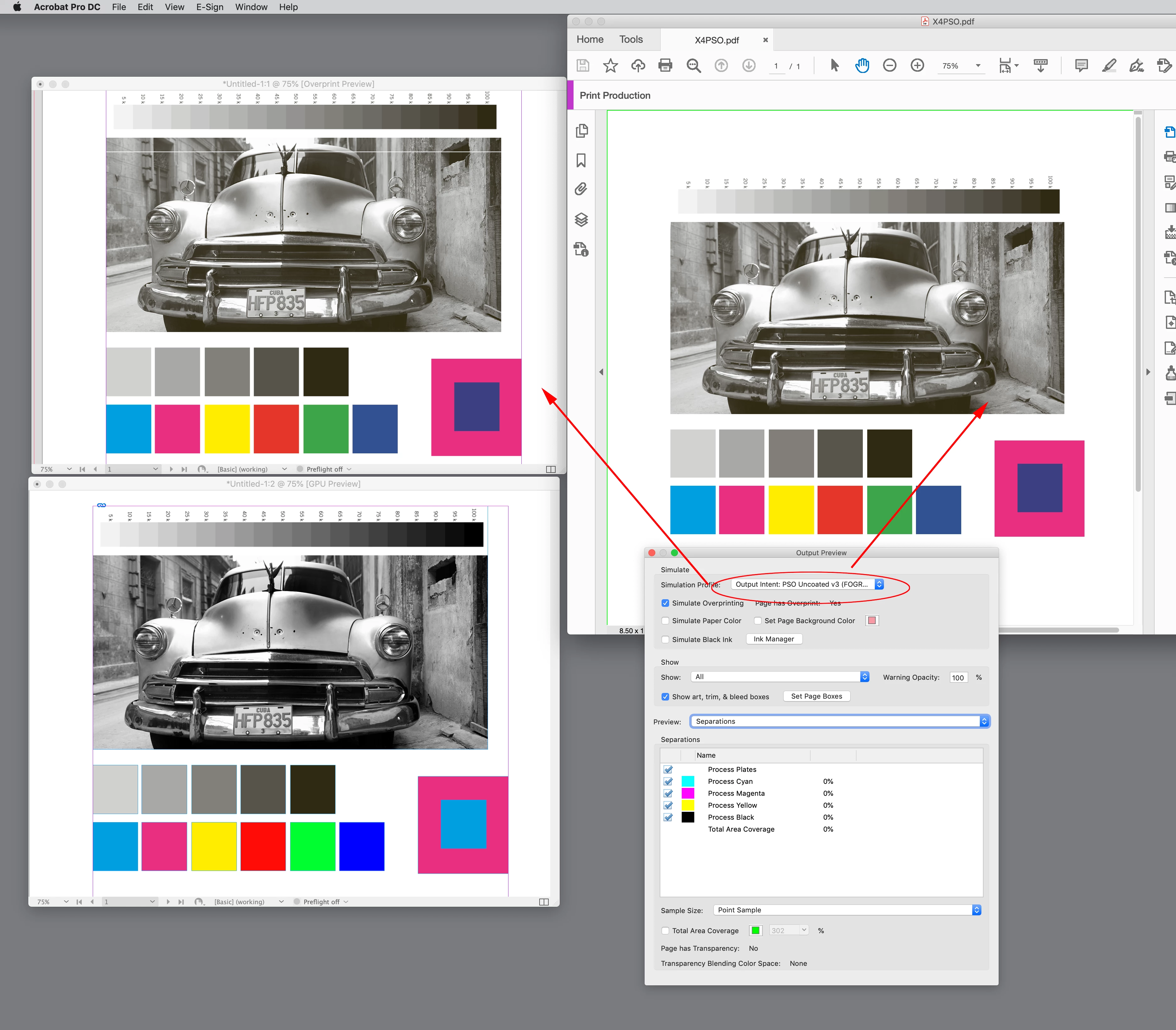

In Photoshop did you convert the sGray originals to the Black Ink profile (Edit>Convert to Profile...), or assign the Black Ink profile (Edit>Assign Profile...) to the sGray original? Assigning the Black Ink profile wouldn’t change the grayscale’s output values.
Not sure if you would call it a bug (I would), but Proof Colors doesn’t display grayscale objects as they would print on the proof setup profile’s black plate—I rarely use Proof Colors
InDesign’s Overprint Preview matches the Output Preview of a PDF/X export’s Output Intent. Top OP turned on, bottom OP off:
