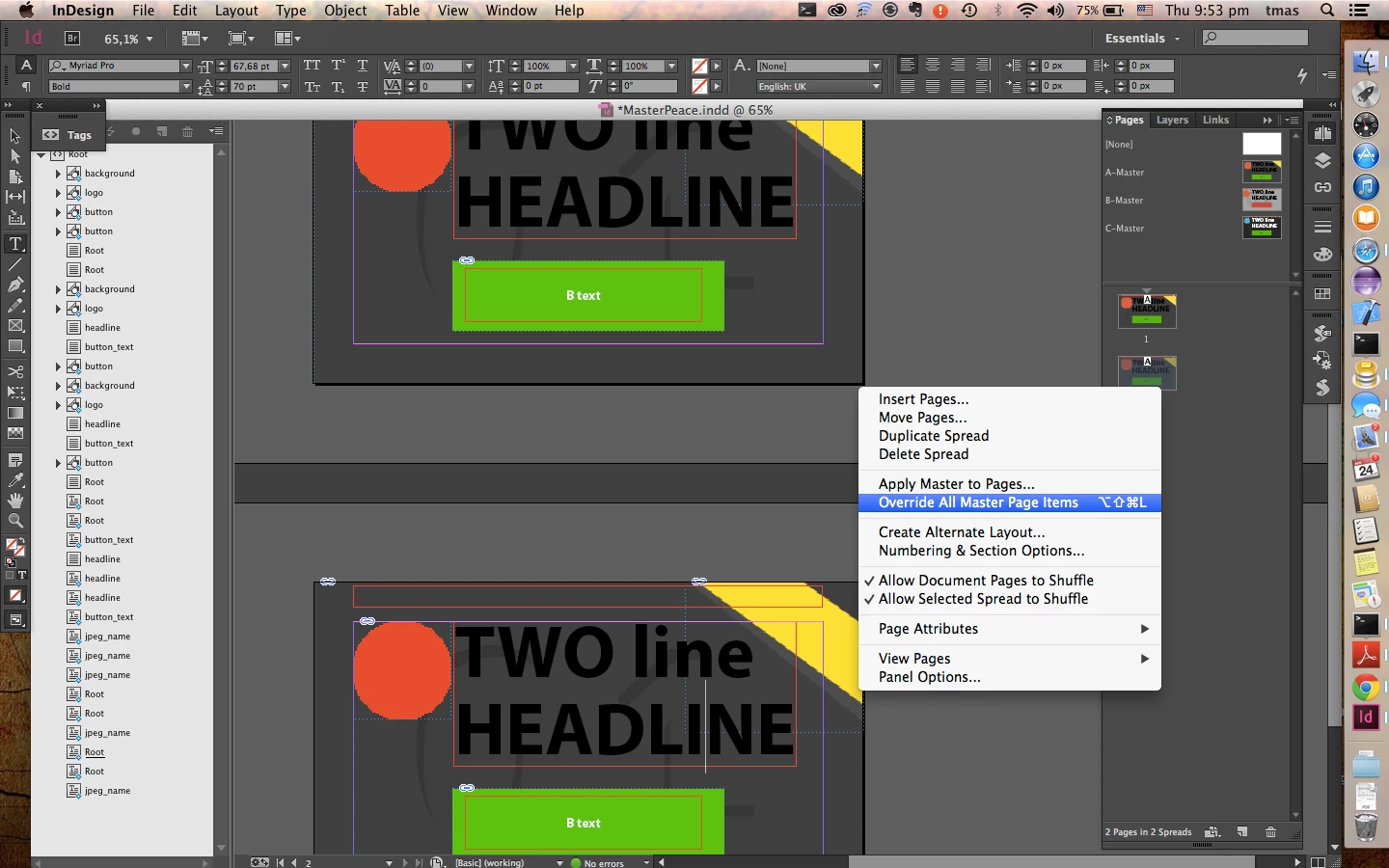

I need to override elements by script and have them end up at the same place they were in master. Now it overrides and puts them to the new page but it changes their position. Here is my function:

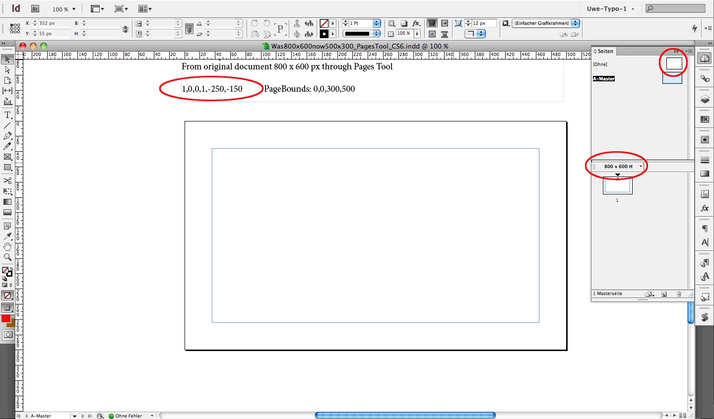

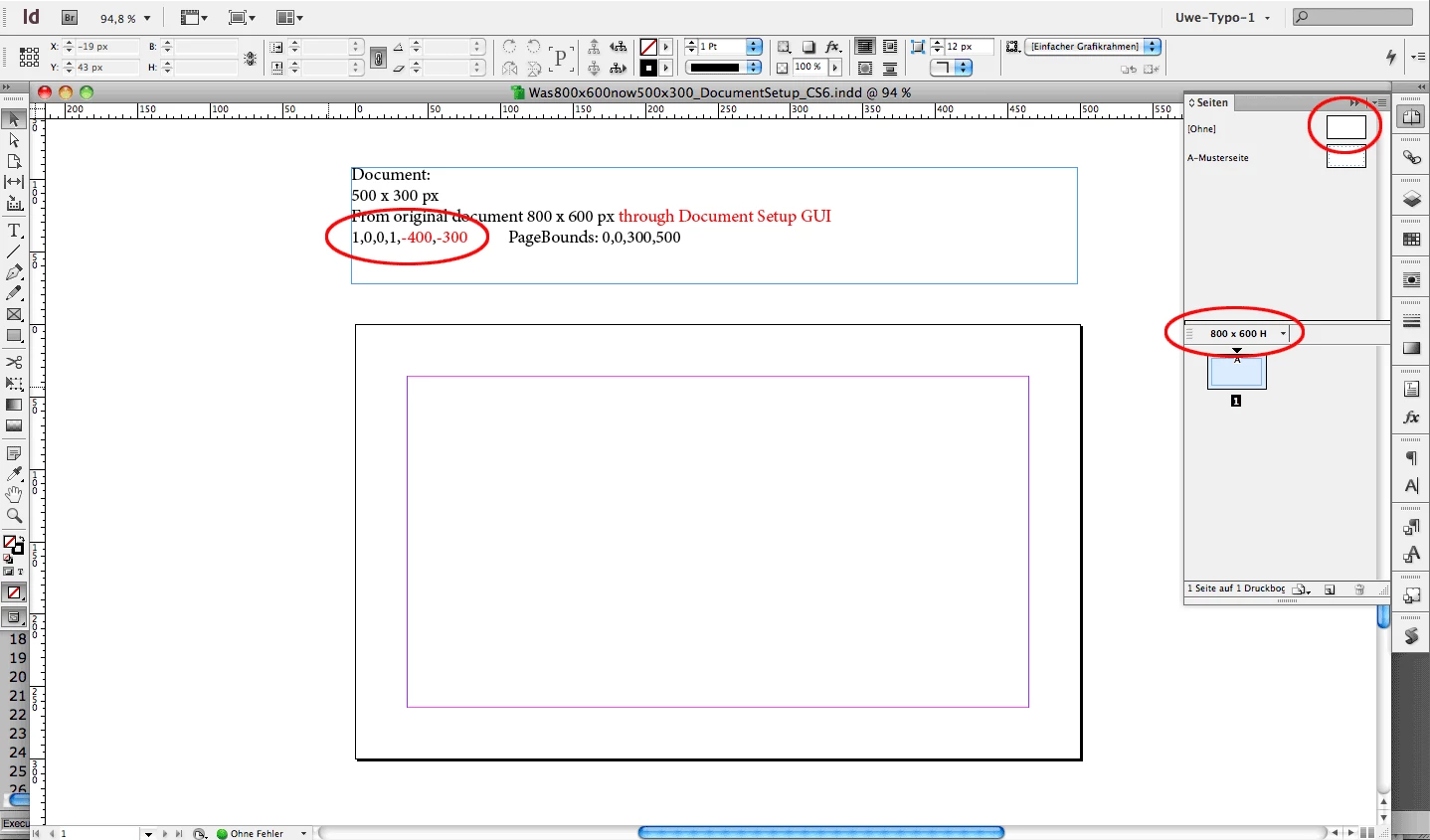

And two screenshots to illustrate the difference of changing document page sizes in InDesign CS6 (and above):
1. "Wrong" or "dangerous" approach with the Document Setup GUI:
2. "Appropriate" approach with the Pages Tool:
"Wrong", "dangerous" and "appropriate" in the sense, that scripting will work as expected without moving overridden page items to their original positions.
To correct the problematic example #1, just use the Document Setup GUI and go back to the original size and change size again by using the Page Tool.

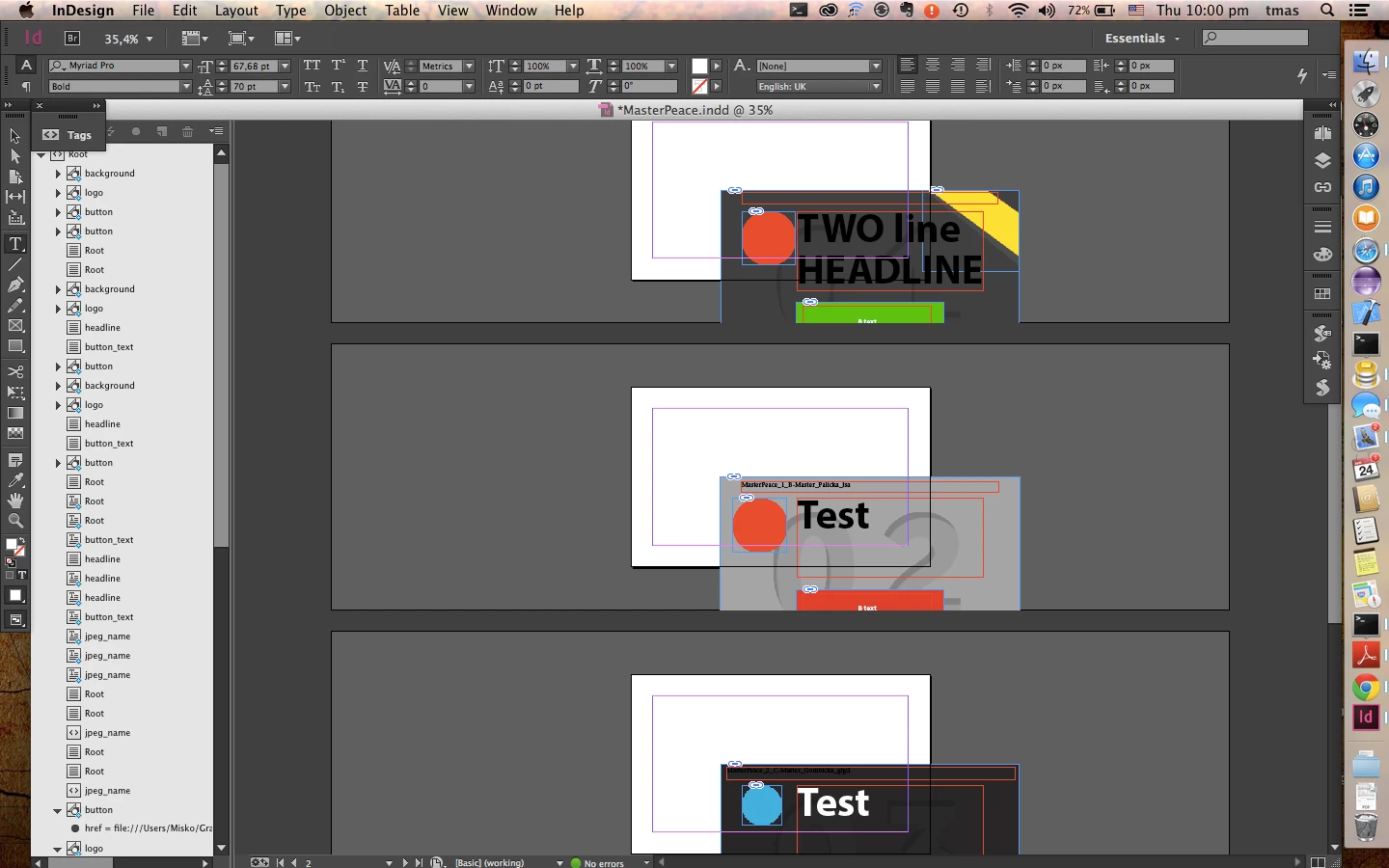

This script is not full, or it's not working on InDesign CC 2014, or am I doing something wrong?
I need simple working script that will override all master page items, and fix those shifting

tomas8Author
April 24, 2014
It looks like pretty much the same, before and after.
This is what I want to do
And this is what it does by script
Harbs.
April 25, 2014
Without seeing your document, I can't think off-hand why it would be doing that.
