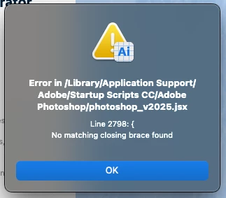

P: Error message (Script line 2798) with InDesign & Illustrator after update
I just installed updates for Photoshop and Photoshop beta and received this error on opening Indesign. Any ideas? [I am on a Mac Mini M4] - there is no error opening Photoshop or Photoshop Beta.

As confirmed by the user, the issue is due to the latest Photoshop update, and the workaround below will resolve the issue.
  • Workaround 1:
    • Uninstall Photoshop 26.5 (make sure to remove preferences).
    • Reinstall Photoshop 26.5. This will install the correct “photoshop_v2025.jsx”.
  • Workaround 2:
    • Open jsx, which is available at "/Library/application support/Adobe/Startup Scripts CC/Adobe Photoshop/" mentioned in the alert in the Text Editor
    • Add } in the last line
Reference UserVoice Thread - Error message is seen while opening InDesign after Photoshop 26.5 update

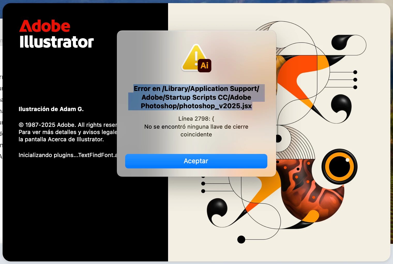

ME APARECE EL MISMO MENSAJE TAMBIÉN EN ILUSTRATOR.
ALGUIEN TIENE LA SOLUCIÓN????

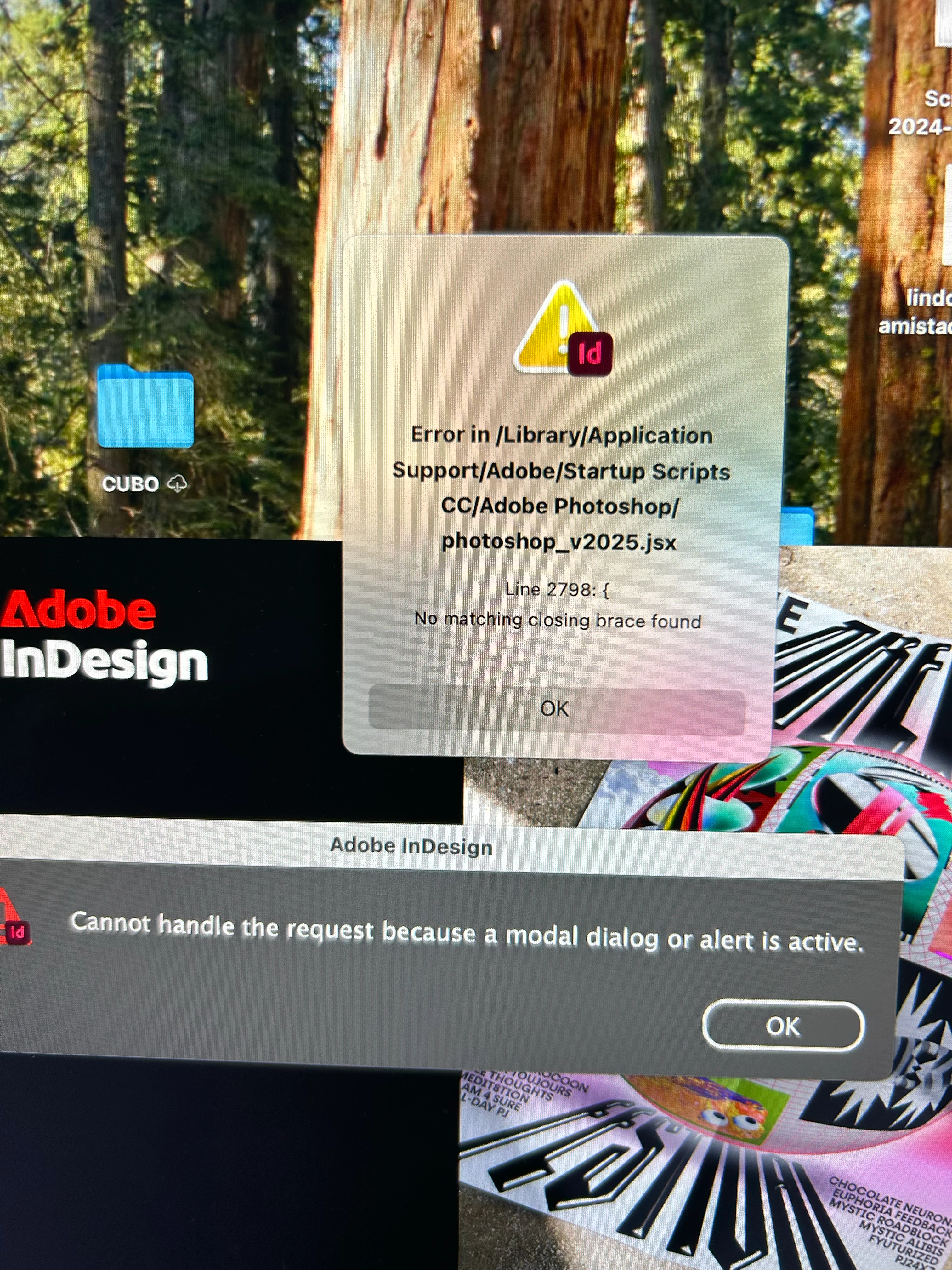

Attempted to open an InDesign file originally created 12 months ago. The placed images will not appear on the screen. Moreover, when I updated InDesign I get an error that a startup script in Photoshop seems to be the culprit. Have restarted InDesign and also tried to update links but no diifference. Anyone any ideas?
See attached window.
Ton Frederiks
April 3, 2025
Did you try the solutions in the correct answer above?
April 3, 2025
Thanks have reinstalled both InDesign and Photoshop and this seems to have done the trick! Now back to work after three hours of unproductive time wasting... Computers eh?

Me sale esta ventana de error al abrir Illustrator 2025 (29.3.1) en MacOs Sequoia 15.3.2
