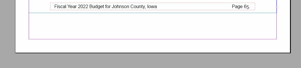

Is there a way to make the page number text box a specific distance from the bottom of the page?  No matter what height page, I always want it at the very bottom.
I have different size pages and currently the page number may end up an inch or more from the bottom of those taller pages.

It is at the bottom of the page on the Master Page.  The Master Page is 8.5X11 letter size.  If I make a document page taller, say 11X11, then the page number is not all the way at the bottom.
