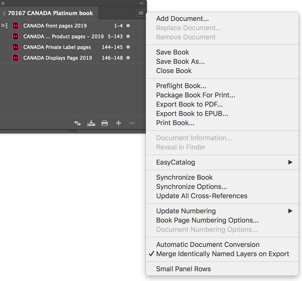

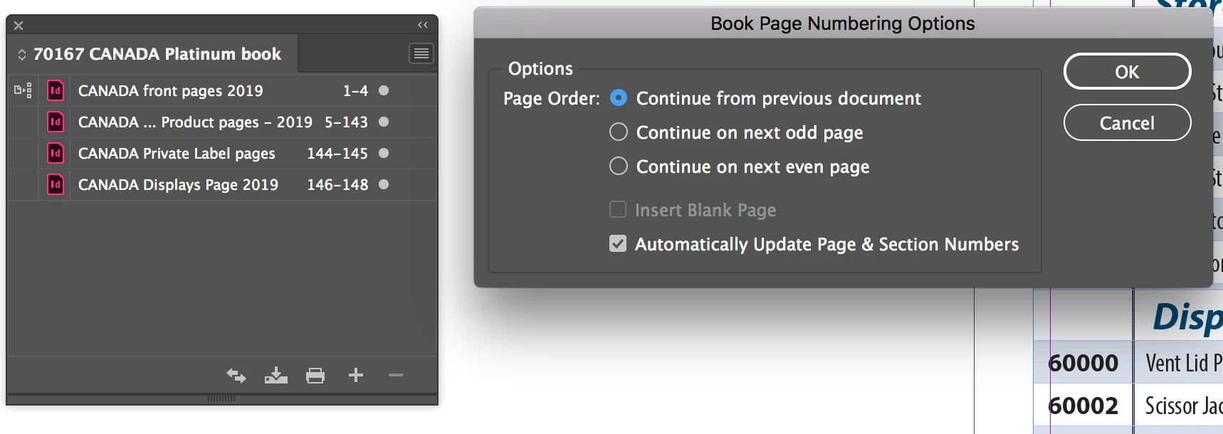

November 21, 2019
Have you checked your book numbering options?
If it is not set to automatially update, then you will need to use Update Numbering in the Book menu to get them to change.
November 21, 2019
Thanks you, but the real issue is the footnotes.
