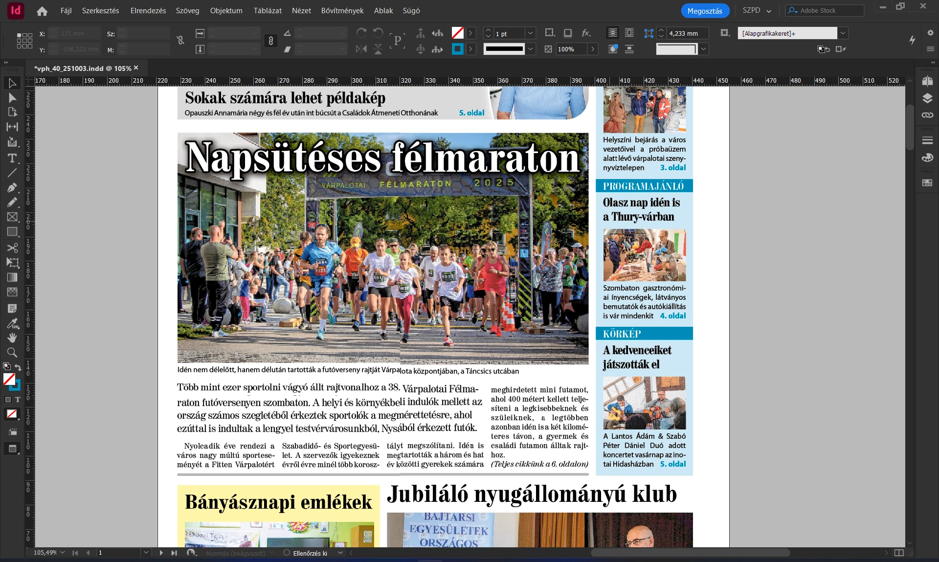

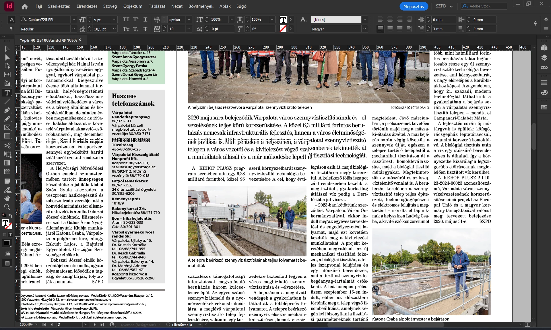

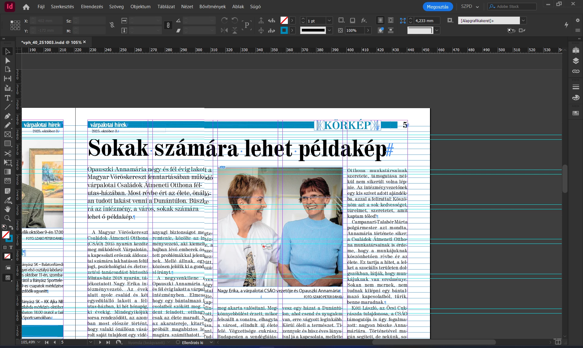

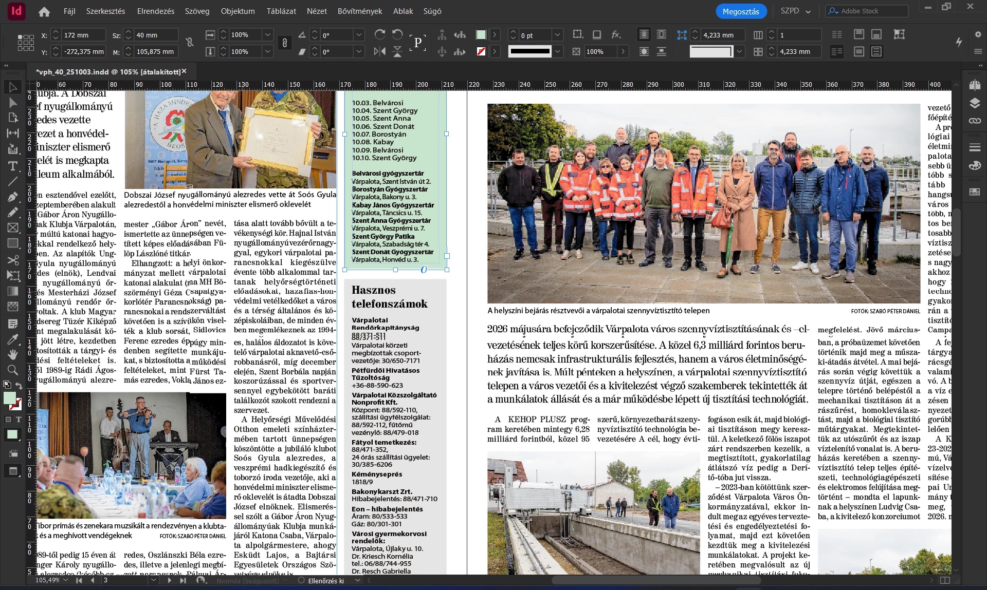

Hi! I'm experiencing page rendering issues after scrolling through documents. This problem occurs exclusively on Windows 11 systems—both on a laptop with integrated graphics and on a desktop with a dedicated Radeon GPU. The rendering behaves normally on macOS; I haven't encountered this issue on any Mac device. I am using InDesign 19.5.5.

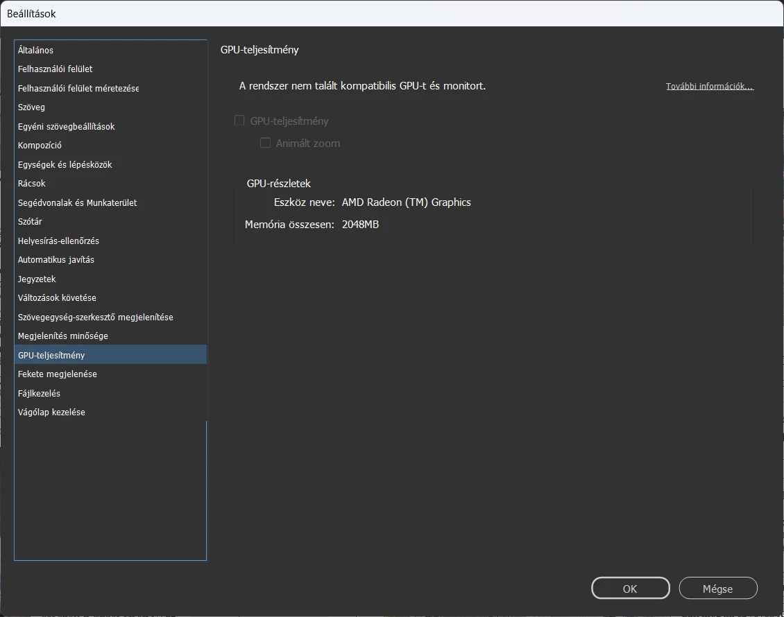

Also, please confirm if your laptop or screen resolution is below 2K, as that would explain why the GPU Performance option appears greyed out. You can learn more about this here: https://adobe.ly/4nZldZa.

Hi! Thanks for your answer! I currently don't have the option to use version 20.5 because my main partner is using version 19.x, but I have installed the latest and greatest version. Unfortunately, I don't have the option to turn on the GPU, as you can see on my laptop with Radeon 7730u igp, but the problem is the same with the new version.

Now, you said you checked it on your laptop where the GPU Performance option isn't available. Is the situation the same on your desktop?
