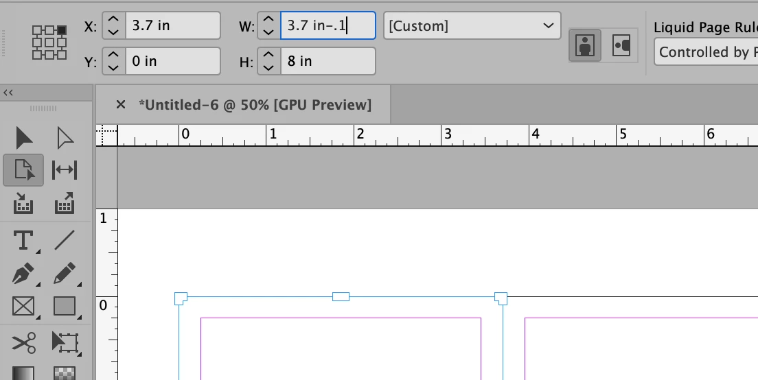

It works fine for me. You appearing to be setting up a 3-panel brochure, and then compensating for the panel to be folded in (I put mine on the left). To start with each panel is 3.7 inches wide. Page tool is selected, and the left-most panel:
The upper right reference point is selected. When I add -.1 to the field it looks like this:

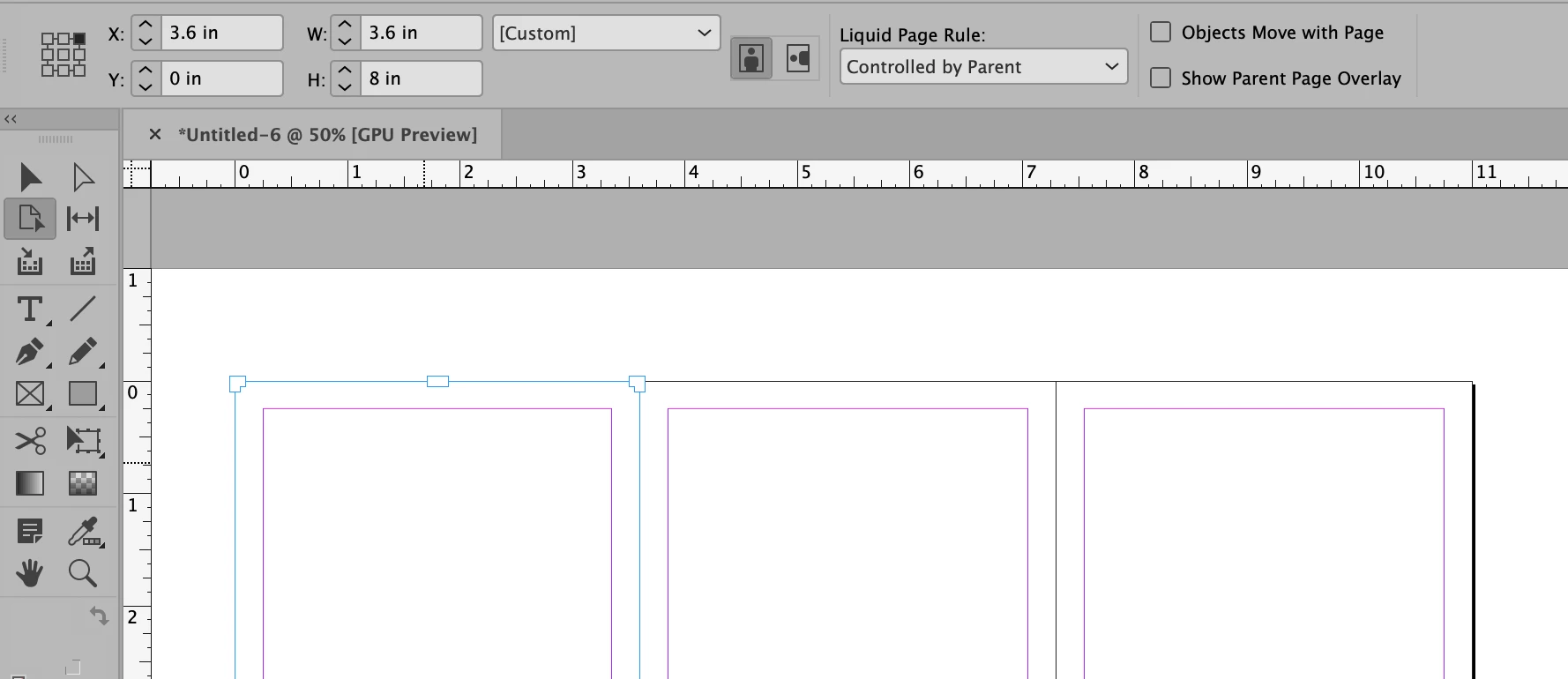

I press Tab to apply the subtraction. The result is that the left panel becomes 3.6 inches wide, the remaining panels remain 3.7 inches.
