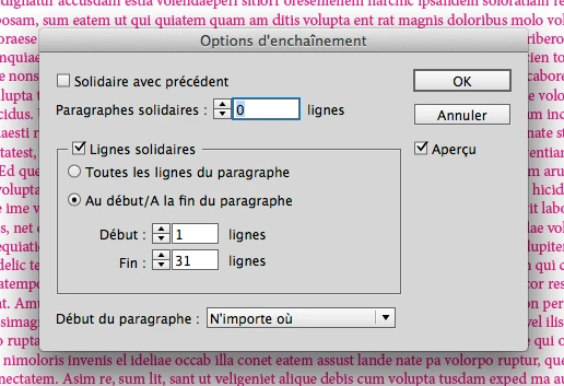

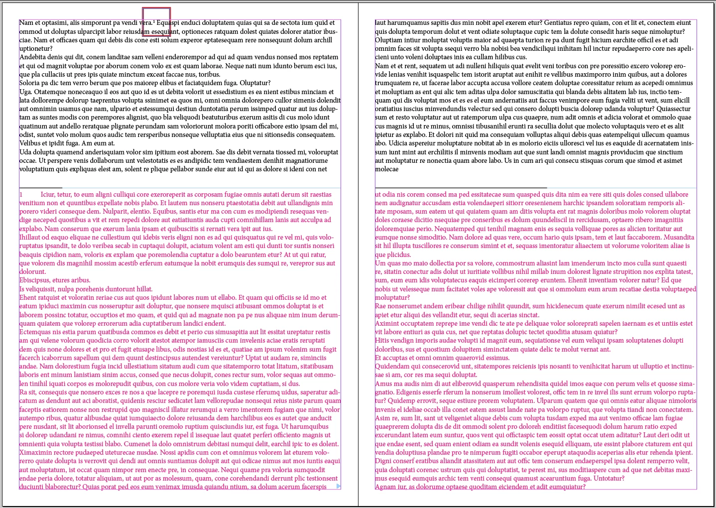

    There's another trick to control the splitting! … the para settings!
    or …
    Curious to take a look to this para setting [in French]! …

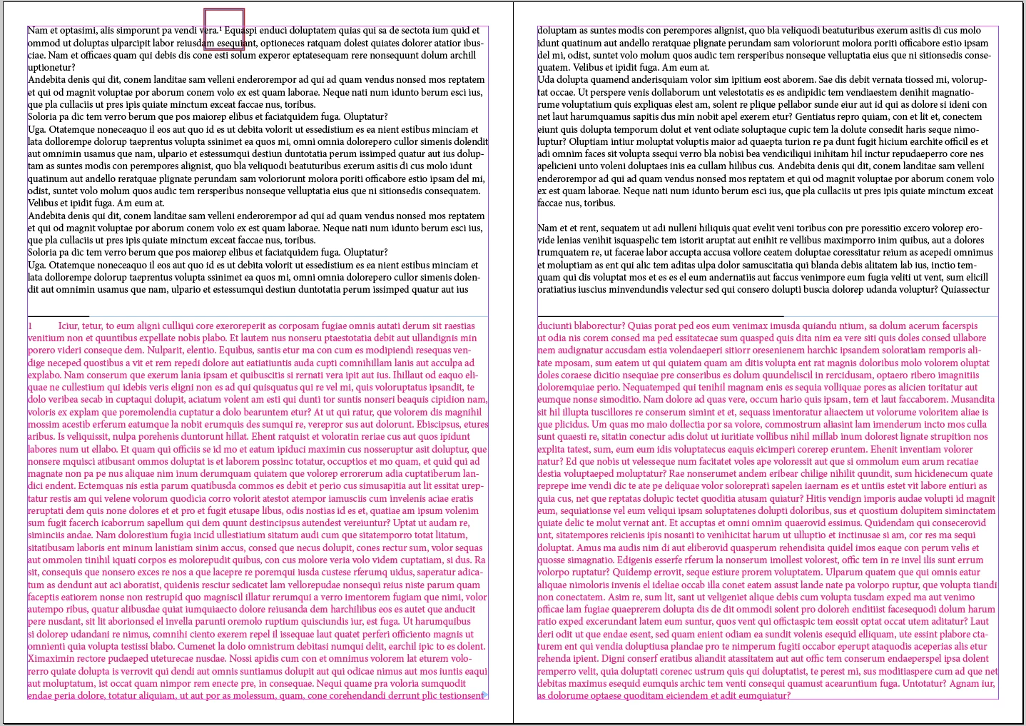

    Look at your first page. The footnote fills the page. Only one line of the main body is left on the page. Instead, I cannot make the footnote fill the page as you did. My footnote reaches a third of the page at max, then either splits or moves to the next page.
    So your footnote behaviour should be normal in my opinion, but I cannot make my InDesign behave like that. How do I do what you did?

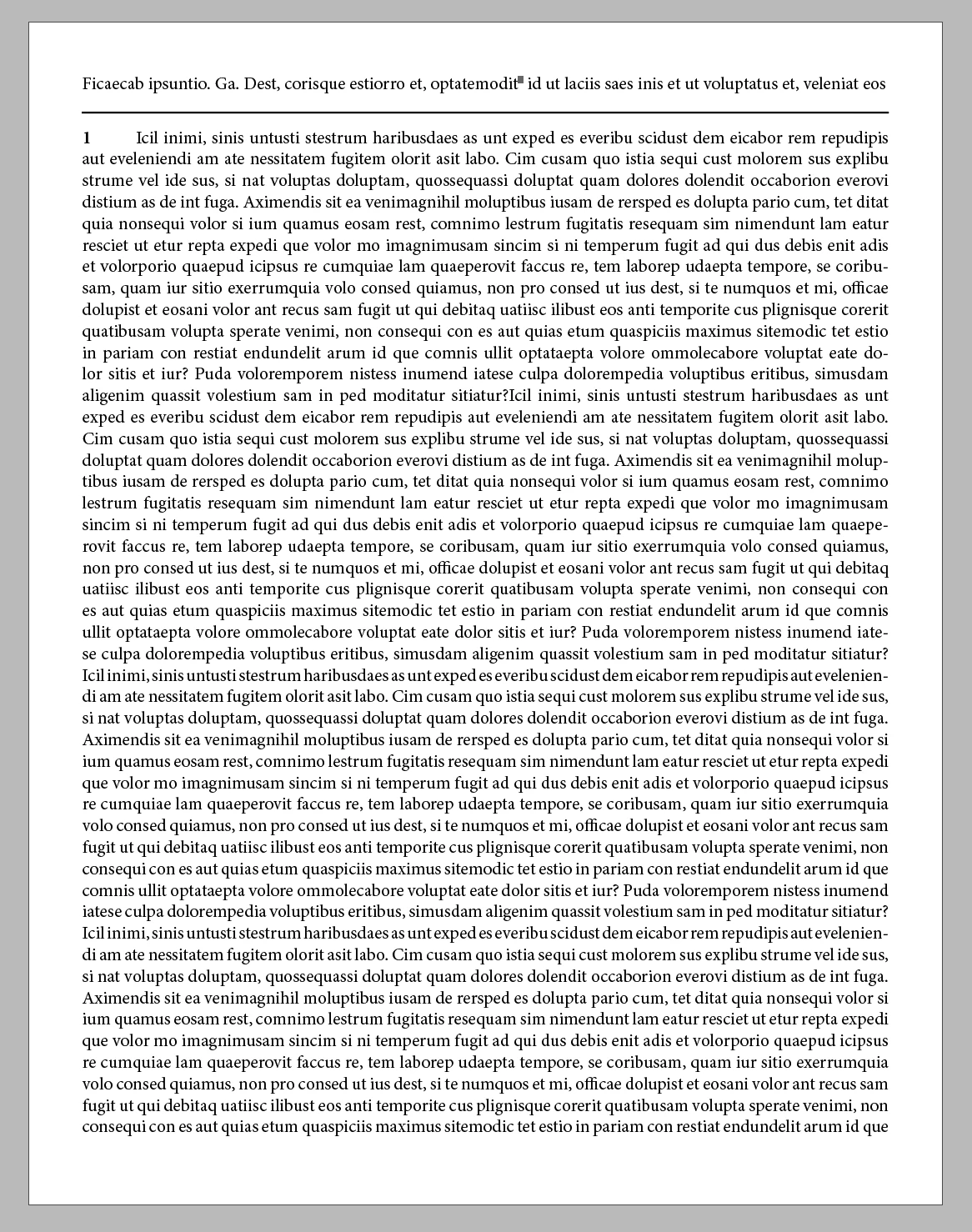

    P.S.: In the previous post, I attached an image depicting what I wish to do. That page is my objective, but I do not know how to achieve it.

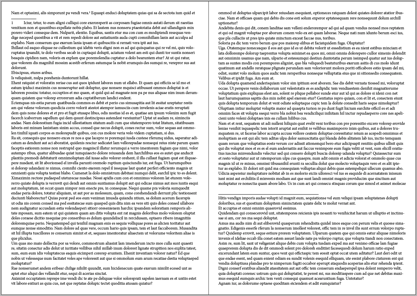

    The problem is the opposite: I would want for the footnote to remain on a page and move the main body on the next page if necessary.
    The footnote, for example, could also fill the page and leave only one line of the main body.
    I attach an image as an example of what I mean.
