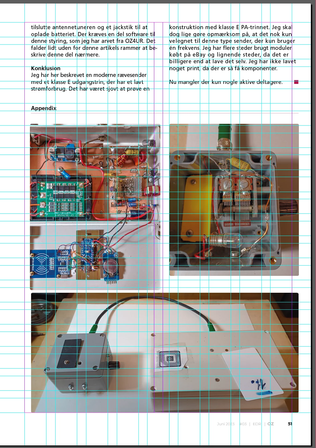

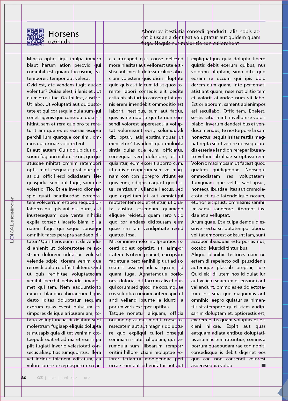

When I make page wraps at the end of magazine production, the layout on some pages slips when pages are moved. It is a huge problem because every time I move one or more pages, the pages slide and I have to go through all the pages in the magazine whenever I have moved one or more pages.
Locking all layers has no effect.
A bleed of 3 mm has been added to the design.
Seems to be a severe bug or any solution?

All items are set as described. The challenge for InDesign is when you use different inner and outer margins. The margins here are created with the golden ratio principle. I could use an ordinary 12,7 cm margin all the way around but that's kind of dull, isn't it?
Really hope Adobe will focus on the issue and come up with a solution. This is very time-consuming and increases the risk of mistakes before printing
