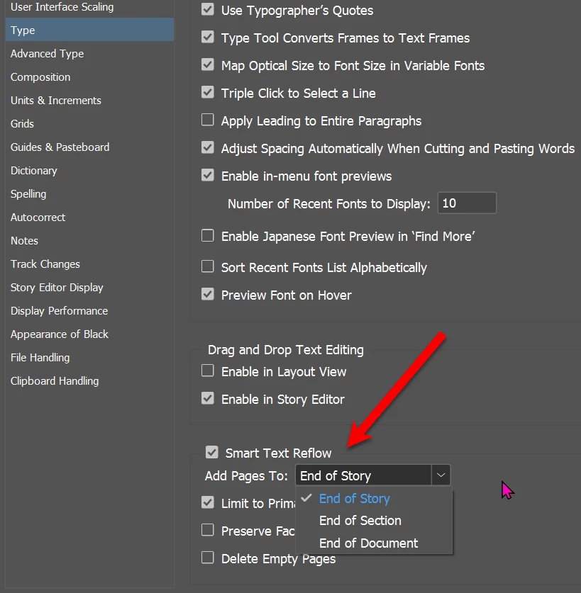

Check your Type preferences:
Sep 4, 2024 9:04 PM UTC
Thanks Dave. I need to turn the Smart Text Reflow off, I'll bet. I'm new to laying out books, so I'll have more questions in the future.

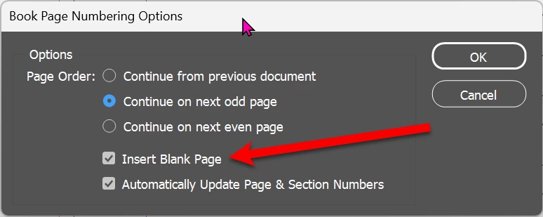

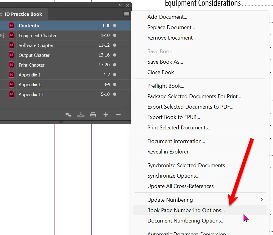

I don't think this is your issue but these Book settings can also insert blank pages:
