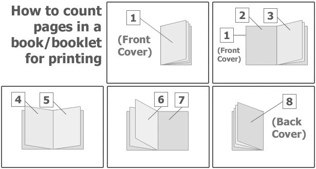

Found this hope it helps
https://insights.printivity.com/how-do-you-count-pages-in-a-booklet-for-printing/
