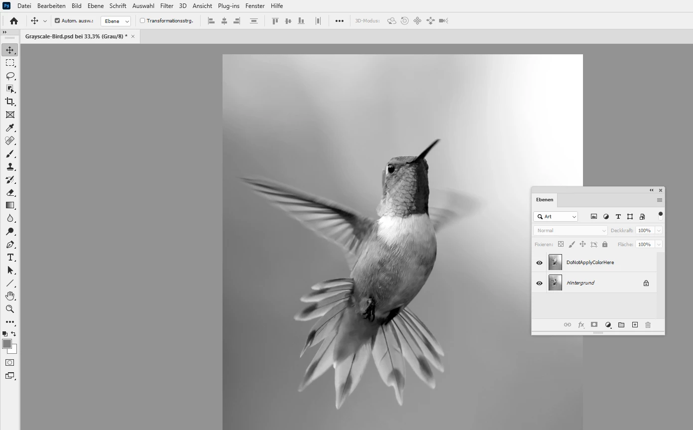

Example grayscale image opened in PhotoShop.

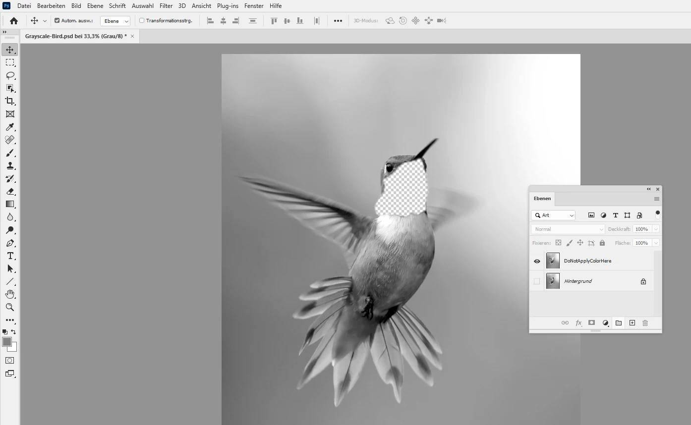

A Background layer plus a layer with a "punch whole".

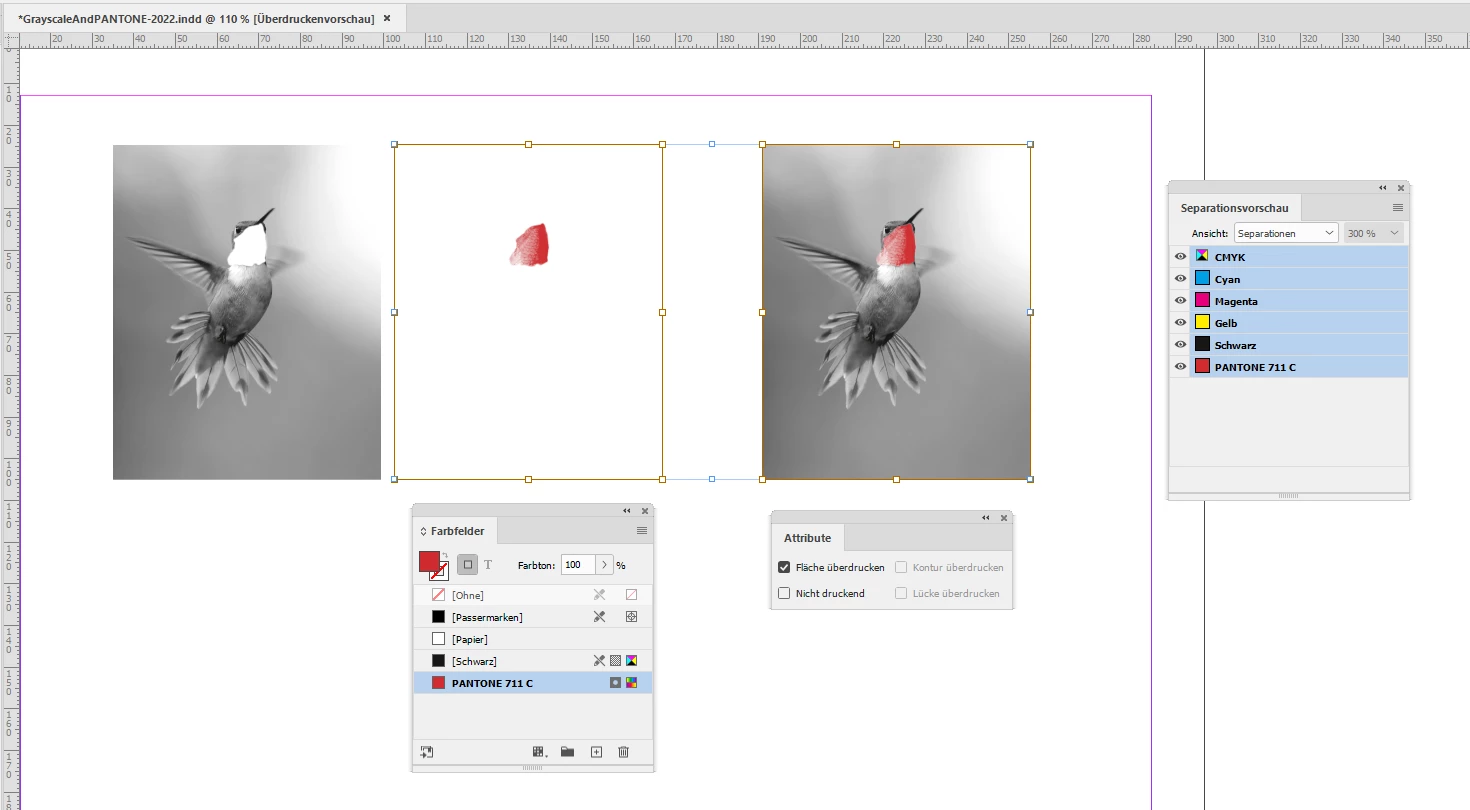

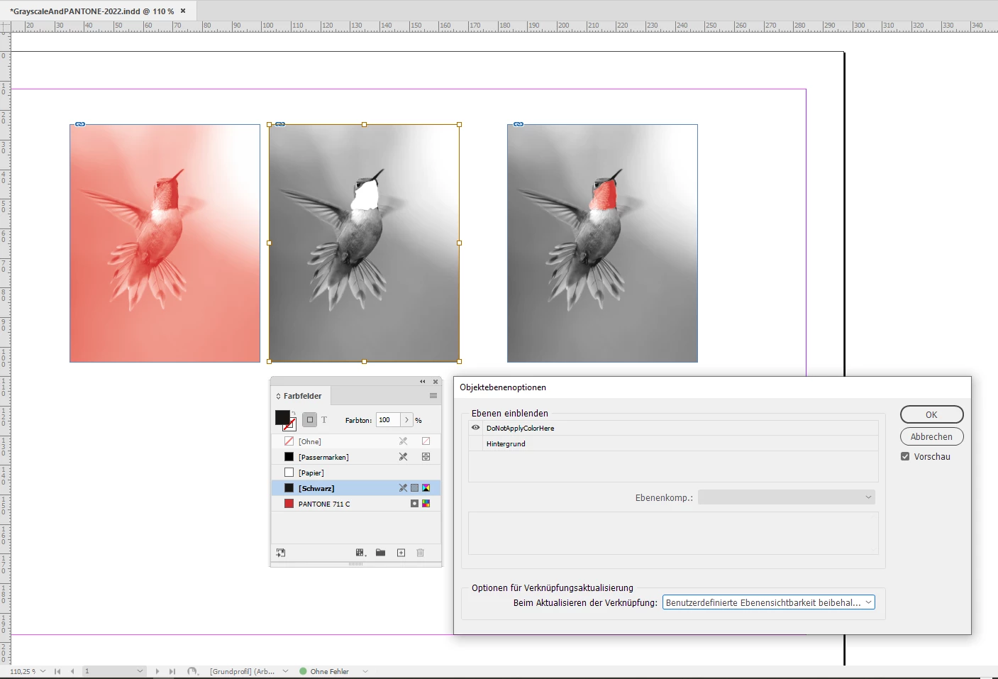

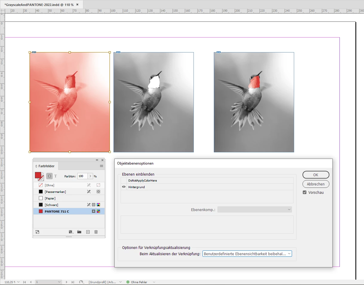

Used in InDesign like that: The same image with two different object layer settings stacked.
The one with the background layer can be colorized. Just apply a spot color swatch to the selected image.
Maybe this is easier:
Or you are using two different grayscale images stacked where you define overprint for the top one:
In this case you could even use two different spot colors if you want.
