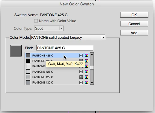

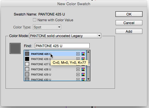

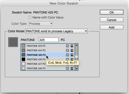

    It was explained to me—by Pantone—that these changes in mix occur because they take into consideration the changes in paper, ink and even printing press changes.
    The changes made starting with CS6 were not simply a tweak of existing color swatch definitions, the color models and libraries were completely rethought and changed. With the legacy all CMYK libraries it was impossible to reliably color manage a solid ink spot color either for screen soft proofing, or for a conversion from the solid ink to a process CMYK simulation. That's why many RIPs resorted to lookup tables for CMYK process simulations.
    In the old system you could not correctly display a color like Pantone Purple C because that color does not exist in any real world CMYK space. You also couldn't tailor a conversion from a solid ink to CMYK for a specific press condition. The new Lab definitions solve both of those problems.
    Providing a single CMYK definition always created a color management problem—and it's still a problem with Bridge swatches—but at least the CMYK definitions have been relegated to a separate library.
    rob day
    October 24, 2017
    My question to Adobe is why has this happened? It is uniform across the board in all apps, prior to CS6 conversion worked correctly.
    Starting with CS6 Pantone changed their swatch color definitions. There is now a clearer difference between spot color libraries (i.e., PANTONE+ Solid Coated) and process color simulations of their solid ink libraries (i.e., PANTONE+ Color Bridge Coated). The solid color libraries are defined as Spot color with device independent Lab values. The Bridge libraries are defined as process color with Pantone's recommended, (device dependent) CMYK definitions.
    If you convert the solid color spot swatches via Ink Manager, the conversion is color managed and the results would depend on the document's CMYK profile. If you don't like Pantone's Bridge CMYK values it is possible to go to an older version of InDesign and get the legacy libraries and use those swatches in newer versions.
    More in this thread:
    Re: Pantone+ vs. Pantone Colors?
    Duncan Press Design
    October 24, 2017
    Hey Rob, I went and did some investigating today, and it turns out that the Pantone Bridge Coated and Uncoated Guide color conversion mixes changed from the same year CS6 came out. The reason I know this is because I have an old Solid to process guide from Pantone dated 2001. Not only that they have stated in numerous community threads on their website that yes, they update and change the colors. So the conversions in the Creative Suites are working correctly, my company is using an older guide and matching from that, which in most cases—is what works best for our commercial offset presses.
    I do appreciate the feedback, and did double check to make sure I had the most current plug-ins for the Pantone Books, and it did lead me to other avenues for answers.
    Have a great day
    Kimberly
    rob day
    October 24, 2017
    Yes that's right. Prior to CS6 all of the libraries actually had the same CMYK definitions, with the exception of Photoshop (Photoshop has always used Lab values for its solid ink libraries). The Pantone+ Bridge Libraries were introduced with CS6, for users who wanted a single Pantone defined CMYK simulation, and they are very different than the legacy library builds.
    I still have the legacy libraries and you can see the swatches are all defined the same, which made it impossible to have an accurate screen preview when the intended output was a spot color ink and not a process conversion.
    The newer Lab values for the solid inks display out-of-gamut colors and coated vs. uncoated more accurately. Also the color appearance is not affected by the document's CMYK profile, so they preview better for spot output.
    The Bridge neutral grays can be problematic because I'm not sure Pantone publishes the CMYK space that was used to make the conversion for the process Bridge library. The older libraries were obviously hand built because you wouldn't get the black only 77%K conversion with a typical CMYK profile.
    The Bridge values for 425 certainly don't seem right under almost any press conditions—I think the conversion of the solid Lab values you were showing (to GRACol?) would be better assuming the press is printing to GRACol.
