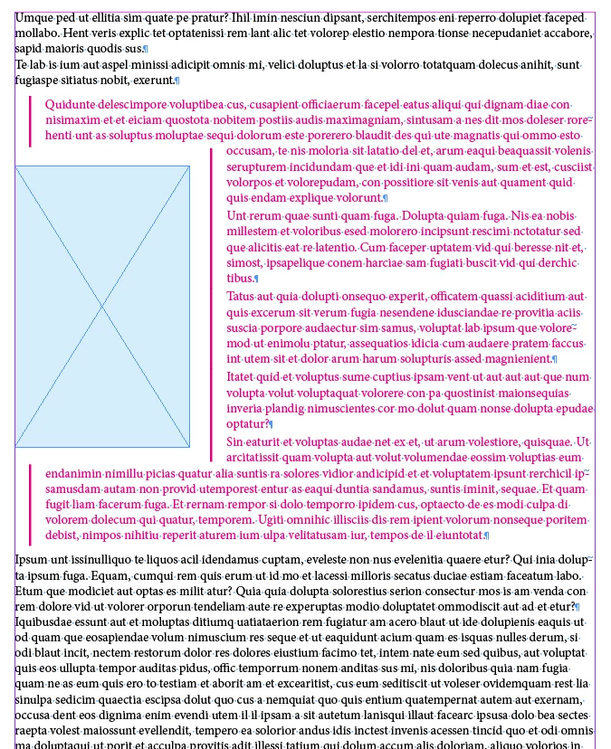

I can't figure out why a text border (left border) style I created doesn't wrap around an object. The border is just ignored and appears under the object frame. See samples.
Border style (top)
The border is ignored when adding a wrapped frame.

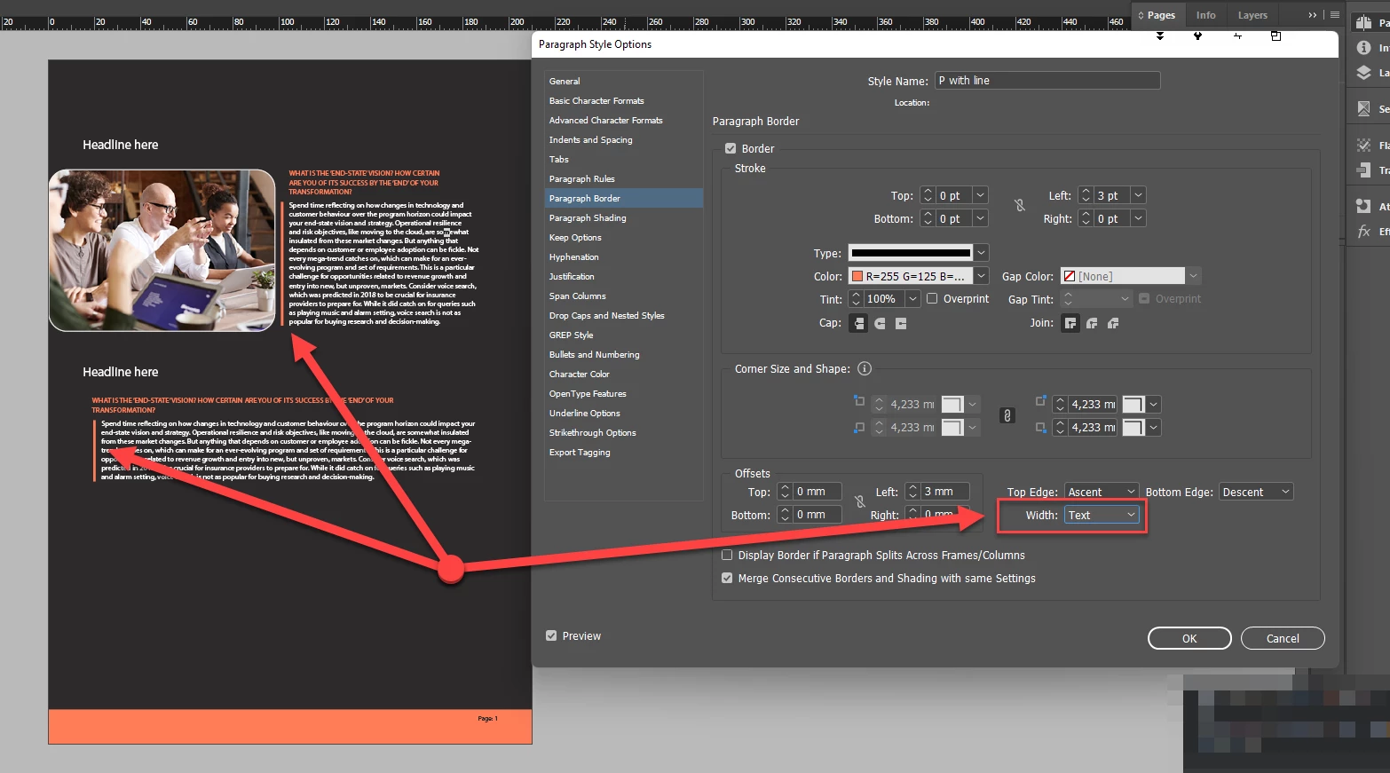

Correct answer Geоrge
@FRIdNGE you are a legend! I don't think this option and what it does even exist in Adobe's help files. Thanks hips.

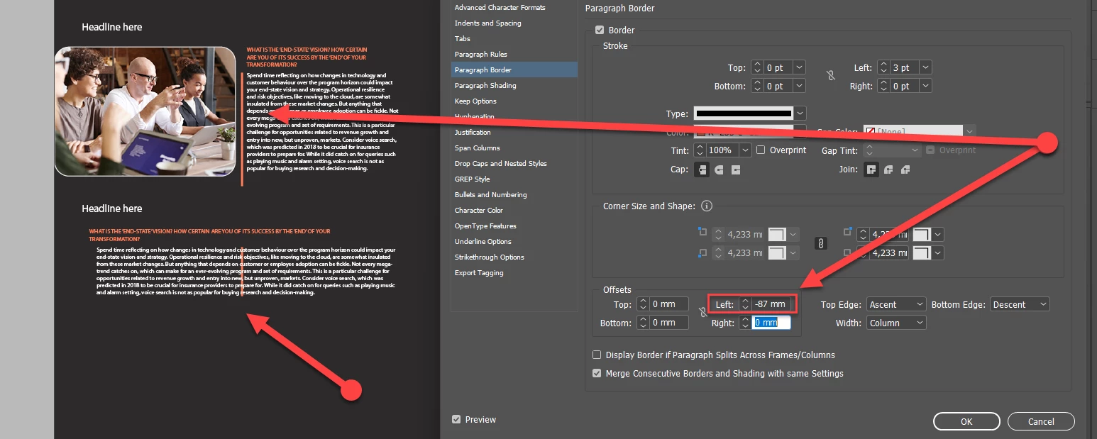

Image for the future readers of this thread:

@FRIdNGE said: "In “ParagraphBorder” tab, use “Text”."
Right so!

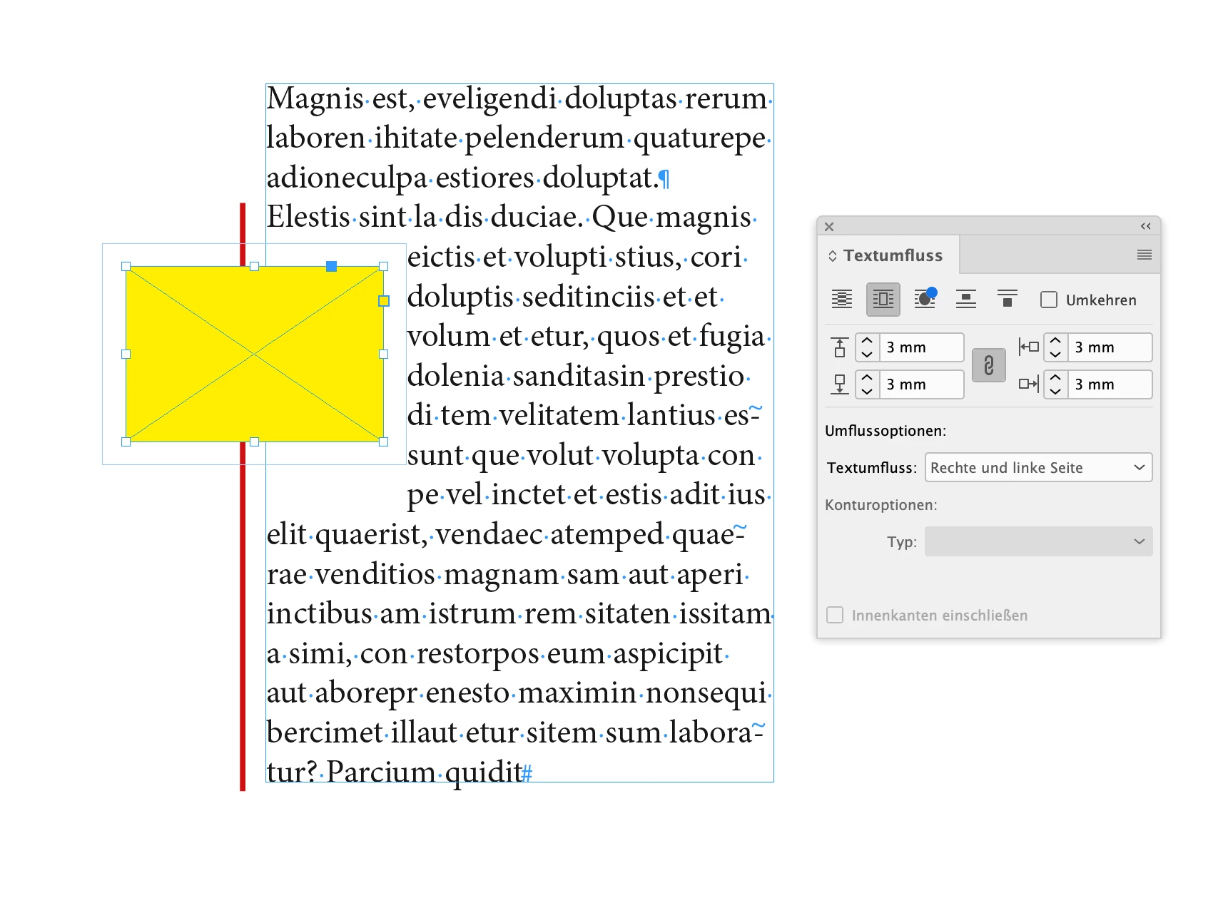

But @migo@kanopi , be aware that the whole paragraph must be affected by the text wrap object.
Two different situation where I used "Text" in Paragraph Border:

October 12, 2022
Oh. Forgot that screenshot that is showing the situation:

Here the workaround below in an image. But you will need to have 2 paragraph styles with this workaround, because frames without near images with wrap will have normal result for this border line.
