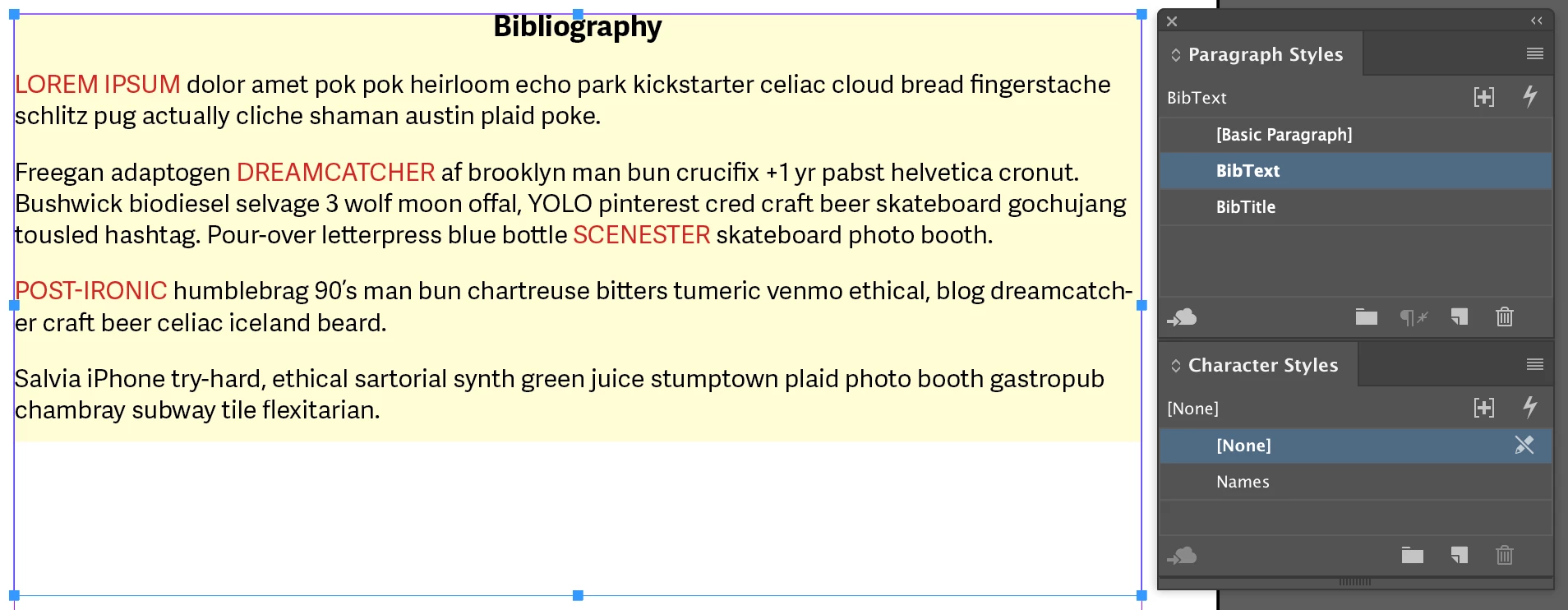

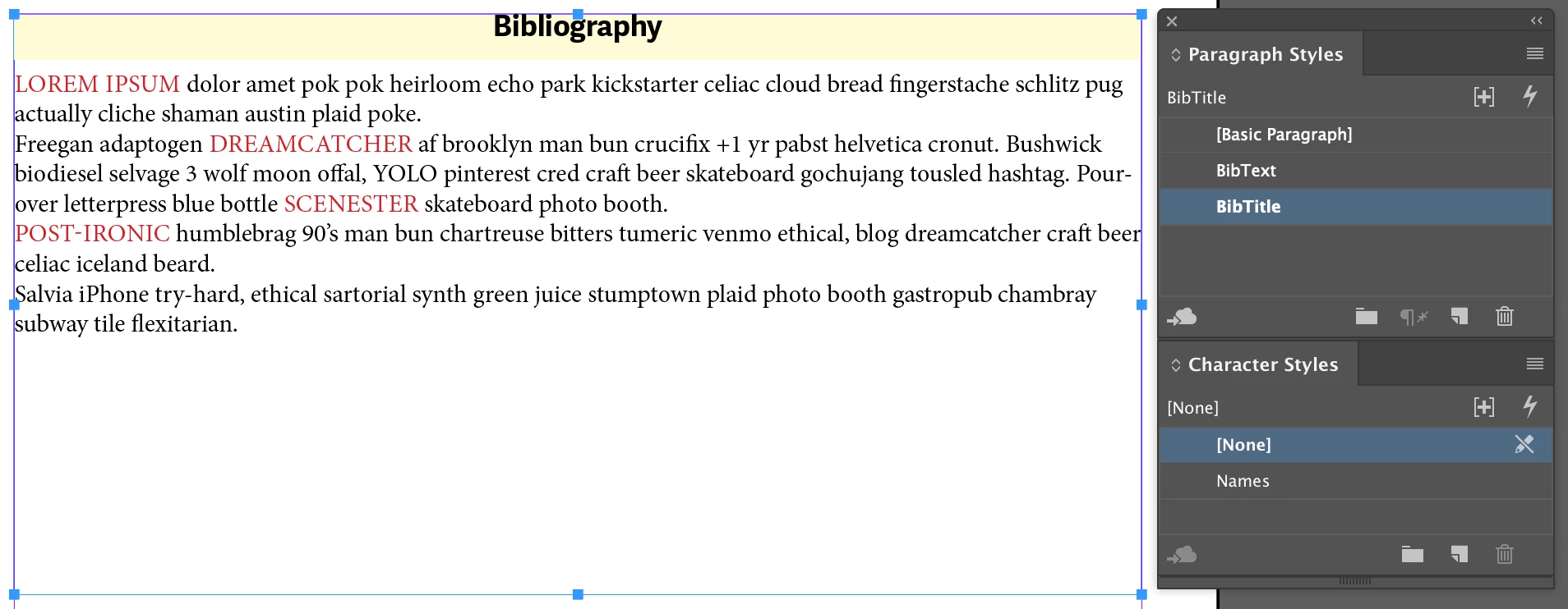

I need to achieve this exact effect on certain paragraphs in an .indd document, I tried using rules below and above I get mixed results, then I tried paragraph shading and that seems to be a bit better. In straight pargraphs with one style its a bit easier but with paragraphs that have multiple character styles  this is a bit tricky. my common thought would be just to place a rectangle on a layer and place behind each text I need to have the effect under. The doc is for print but before I do and then go back later and see the procedure I used ias not correct i figured I would ask now.
Any help?
See screenshot

    I would encourage you to set this up using one character style for the red text and two paragraph styles with a shading defined.
    ~Barb
    ~Barb

    If the red names occur with much frequency throughout your document, you could also add a simple GREP style to the existing Paragraph style to automatically trigger the Red All Caps Character style.
