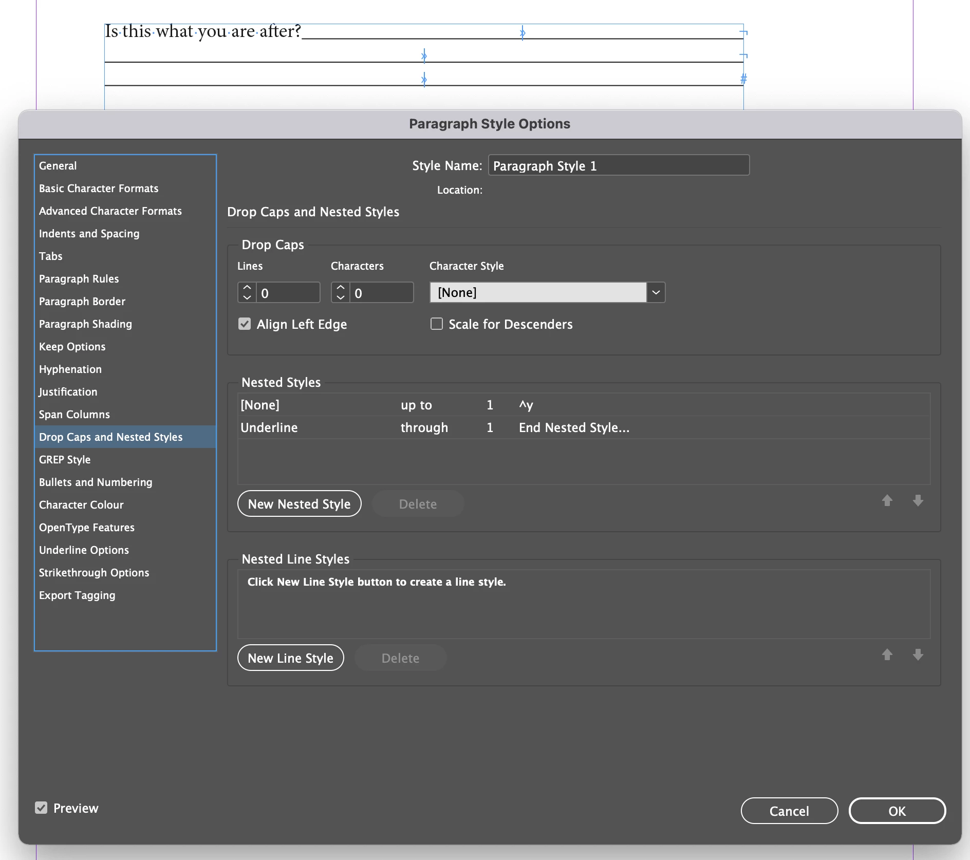

Try using a nested style that applies no style up to a right indent tab (Shift+Tab), then an underline character stlye up to the next End Nested Style character. Press Shift tab at the end of the line, thn add a line break (Shift+Enter) and another right indent tab for each line you want to add.
When setting up the nested style use ^y as the trigger for the style, since you can't select a right indent tab from the pop up menu of available conditions. You can actually enter anything in that field, you are not limited to what is in the menu.
