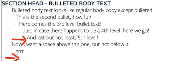

Hello!
I'm somewhat new to paragraph styles and am trying to set up a template for step-by-step guides, which includes a lot of bullets. Each line in the screenshot is its own paragraph style.
I'm wanting a .0625 space between each set of bullets without adding an extra return between them, but I can't just apply that to the 5th level bullet because some steps only have 2 or 3 levels. I can't add the space above the first level bullet because that would add too much space between the first bullet and the section head.
Is there a way to achieve what I'm wanting or would I just manually make the space each time?
Thanks!

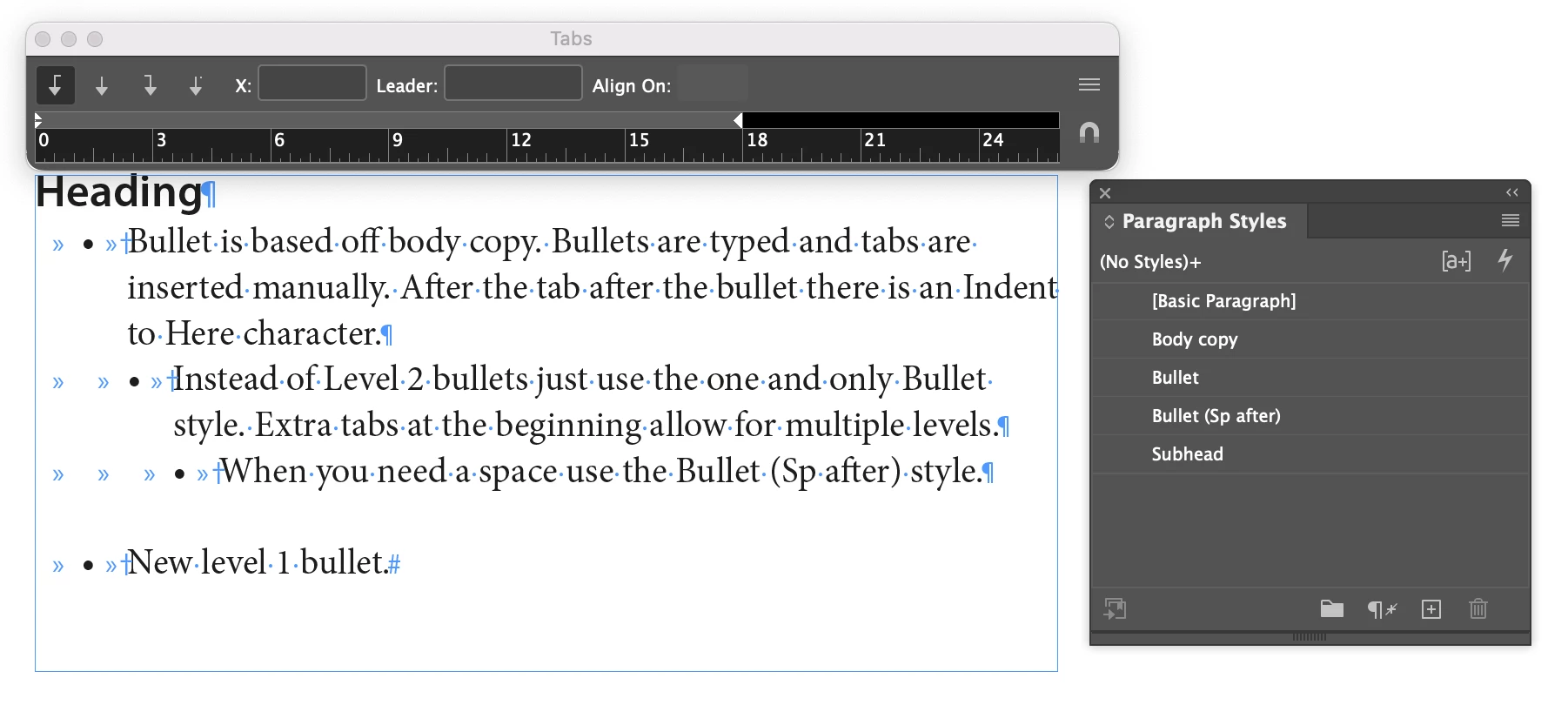

Correct answer Scott Falkner
It might be easiest to create a paragraph style for just the space then add that when needed. Give the style no space before or after and make the leading the size you want the space to be. In my example leading is 14 point (as is each successive indent for the bullets). The space is half that. Because it is a style I can globally change it without having to change multiple paragraph styles or adjust every override.
An alternative is to use only one style for all bullets. This will require manually typing the bullets and the tabs, but as there is only one style, style management will be easier and you can have one basic bullet style ans one with space after, as below.
Scott Falkner
Scott FalknerCommunity ExpertCorrect answer
June 22, 2022
