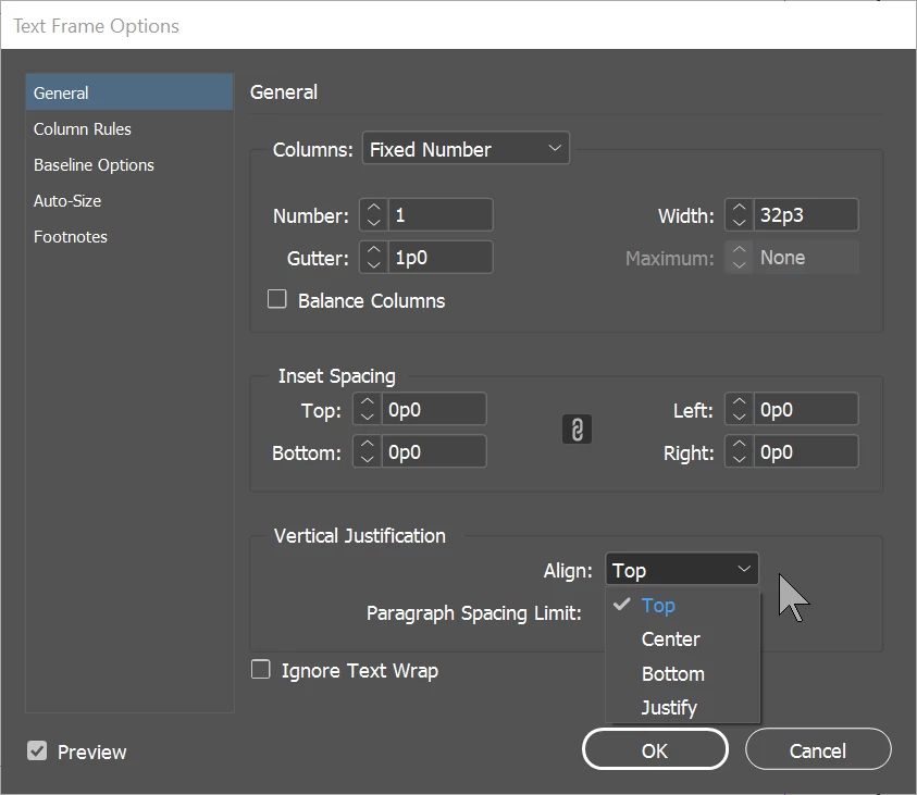

Left to right alignment is part of the paragaph style; it is under the Indents and Spacing section. However, you mention align bottom, so if you mean vertical alignment, that is an object-based setting. It would be the Text Frame Options under the Object menu. You can use an Object style for this setting.
